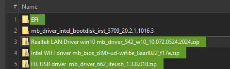

I'm trying to set the color for the "today's date" file highlight. It is now white text on light green. I'd like to make the background darker green or change the text to black.
How it looks now:

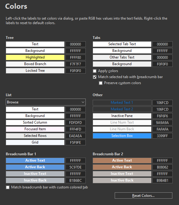

The white text on green does not appear as any color on the "Colors" dialog.

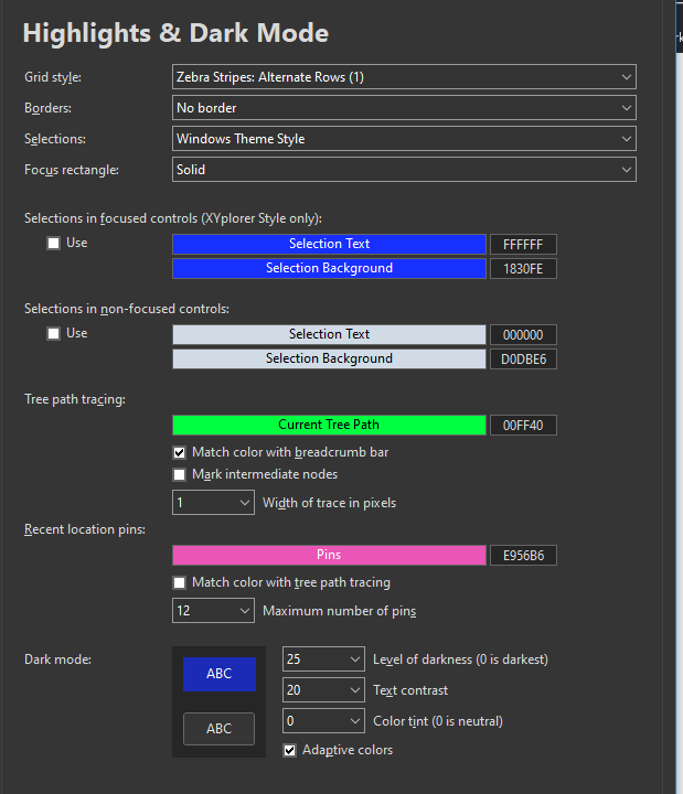

There is a setting for "tree path tracing" on the "Highlights and Dark Mode dialog which was black text on green background. I changed it to darker, but it has no effect in the XY display, either in the file pane or the tree.
