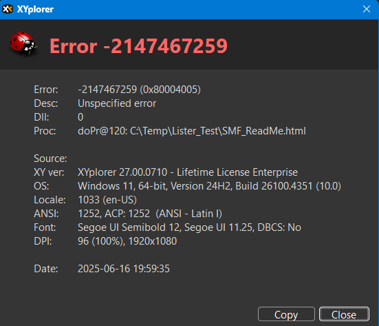

Most previews are working fine now,
but .html doesn't work at all in the preview pane.
Screenshot - 16.06.2025 , 19_59_51.png (21.88 KiB) Viewed 2969 times
Posts: 14638
The same goes for .htm and .mht files...
Posts: 4407
And that's the same error I reported earlier with an animated gif.

Posts: 65236
brianhuahin wrote: 17 Jun 2025 10:51 Preview pane major improvements but still an issue with SVG. I love that code.
Should soon be fixed.
Incl. HTML and anim-GIF.
