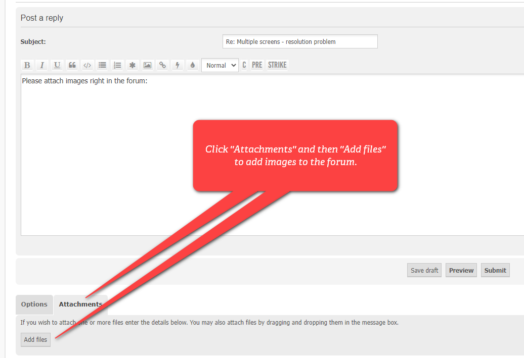

Please attach images here in the forum (attach any videos as ZIP files):
