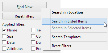

You can do this easily. When the results of a previous search are displayed, right-click the Find Now button and click Search in Listed Items.

admin wrote: 25 Dec 2024 10:44 You can do this easily. When the results of a previous search are displayed, right-click the Find Now button and click Search in Listed Items.
Thanks, this is the solution :D
But you must confirm, better would be a button in this dialog
and not hidden in the context menu of a button :biggrin:
Posts: 66518
Re: How to search the search list
Yep, but where? No space.
Oh! That will solve my problem :shock: Thanks :D
As Horst says it would be really nice if this functionality was more visible, but now I will know how to use it.
