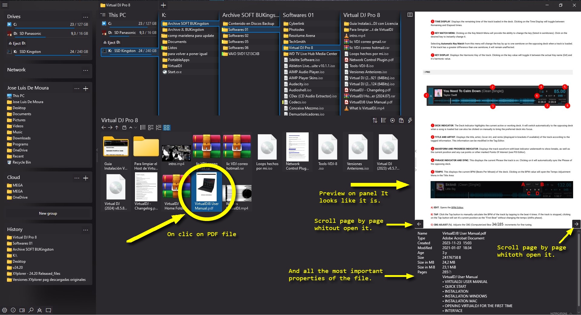

The OneCommader program displays PDFs with a single click and can be reviewed page by page exactly as they are on preview panel.
Attach OneCommander example Pic.

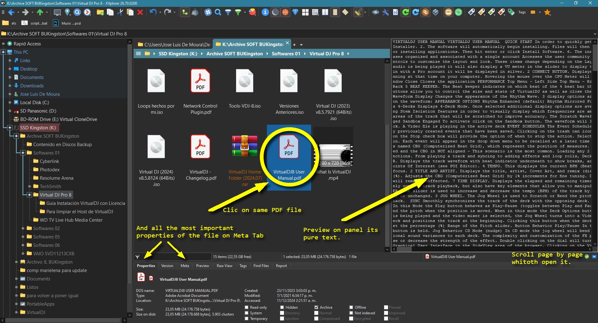

On XYplorer they are seen now in pure text.
Attach XYplore example Pic
I wish that in the preview panel on XYplorer, I could see them with a single click like the OneCommader program does.
