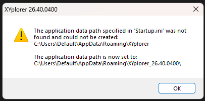

Hello, since I upgraded to 26.40.0300 (from 26.00 I think) I get the following window error:
Screenshot 2024-10-02 154608.png (7.76 KiB) Viewed 3342 times
when I do an "Open Folder" command from another program (i.e. Syncovery).
The folder opens ok, but I have to press OK to close that dialog.
What might be wrong?

Hi.
I closed xyplorer while the previous message was given, and now it gives this:
Screenshot 2024-10-04 125105.png (11.63 KiB) Viewed 3240 times
Therefore, I think I am close to solving the problem...

root != Default

Yes, also see the two edits above.
The xyplorer starts as root. I don't know why default came to play.

Strangely enough, I don't have any startup.ini in my %appdata%\xyplorer\ folder.
That's not strange, that file is in XY's installation folder.
Open it, change the path to the correct folder

Tried that, unfortunately no change in outcome.

Solved it myself.
Options / Shell Integration:
For all users -> [Y] XYplorer in shell context menu, [Y] XYplorer is default file manager.
Current user -> [Y] XYplorer in shell context menu, [n] XYplorer is default file manager (could be [Y] as well, i just like it [n]).
and set startup.ini path to a folder accessible from all users (and of course moved the profile there from %appdata%)
(practically a portable installation with common settings for all users - I'm ok with that)
The problem I had rose from the fact that I run programs in my desktop but outside of my user space. These programs tried to invoke xyplorer from somewhere unexpected and thus the strange messages.
Now everything works ok (even on latest xyplorer versions).
Thank you for your time!
