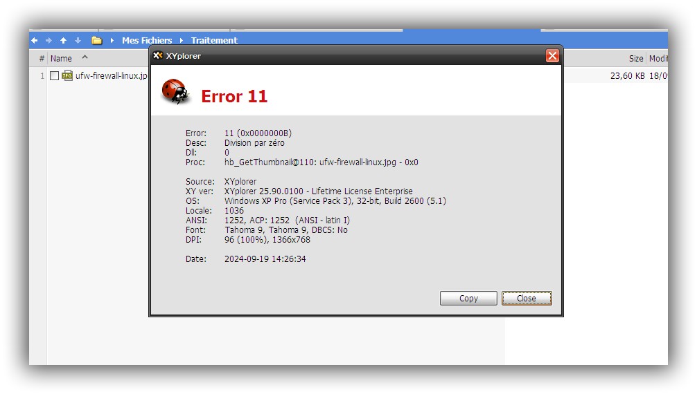

Hello,
The issue only exist on XP systems, on Windows 7 systems and up, the issue doesn't occur.
This JPEG file is an exception, nearly all JPEG files are previewed correctly.
I have joined the JPEG file to this post as an attachment.
The file is opened in ACDSee without issue :
Regards

- Posts: 67205
Re: Preview issue with some JPEG files on XP systems
Interesting case. Could not repro it (no XP handy), but it will be handled with more grace in the next beta.
PS: I assume you got the same error when previewing the image in the preview tab?
Yes, always an error:
Regards

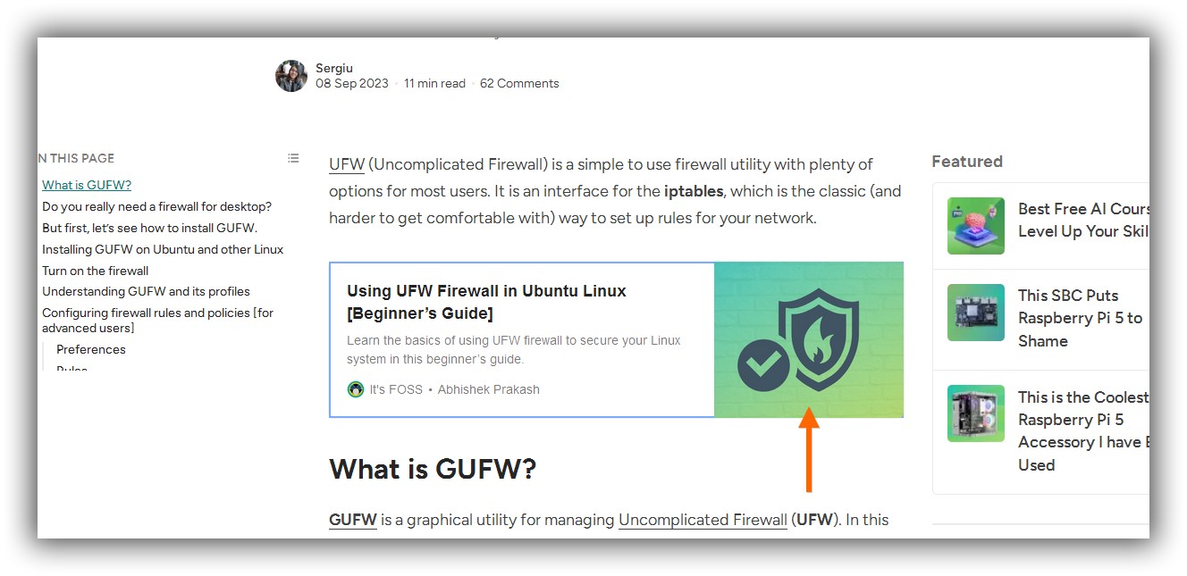

It's the first time I have an issue like this since 2011 (date of purchasing of my licence).
The file comes from this web page :
https://itsfoss.com/set-up-firewall-gufw/
In addition to the error, the file is locked by XYplorer once the error is displayed.
I need to close and restart XYplorer for moving or deleting the file.
Regards
Regards
- Posts: 67205
This should be fixed as well in the next beta.

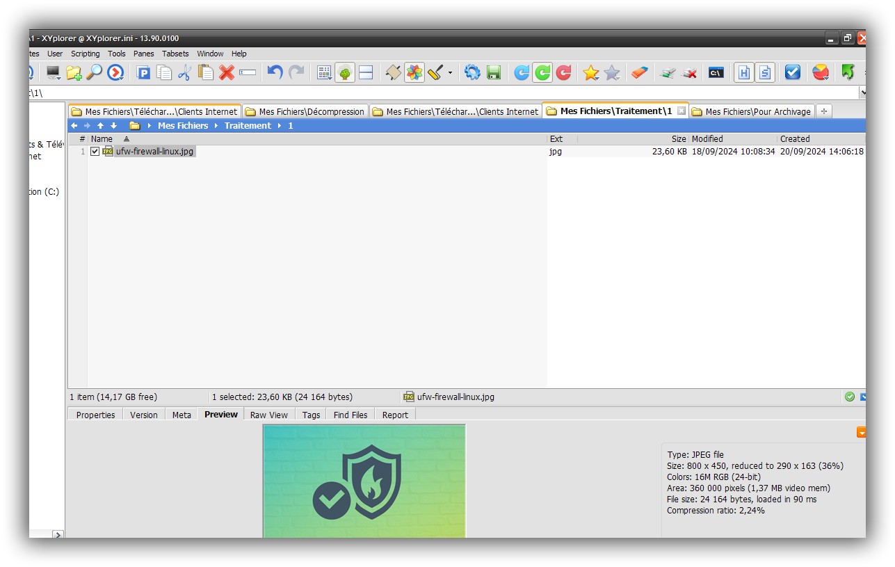

pixelsearch gave me an idea.
I did a test with XYplorer 13.90.0100.
Something seems to have been broken.
The error 11 is fixed in the latest beta.
Regards
Regards
- Posts: 67205
Indeed.genieautravail wrote: ↑21 Sep 2024 07:08 pixelsearch gave me an idea.
Something seems to have been broken.![]()
