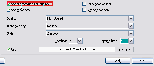

Hi tbm,
There are options to "show dimensions of original" (in thumbnails view) and to increase the number of caption lines. Hope it helps.

Re: Adding filesize to Thumbnails view
My bad, I just realize you needed the file size, not the dimensions.
Thanks, yes I've got the dimensions showing, just trying to get the filesize displayed. Will keep looking!pixelsearch wrote: ↑31 Jul 2024 22:27 My bad, I just realize you needed the file size, not the dimensions.
