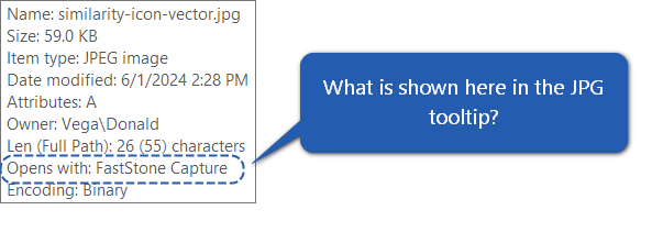

Posts: 66530
Re: Windows 11 keeps asking "Select an app to open this .JPG file"
What is shown for "Opens with" in the JPG tooltip?

It actually doesn't say. But that isn't limited to JPEG files, the tooltip is much shorter than your example. Also no other file type tooltip has that information, including those that open fine without any "open with"-prompt (like PDF).
Since I've used XYplorer for a long time, I might have a legacy setting somewhere I'm not awayre of? Like something where the default has long since changed? I did check the settings for "tooltip" and not a lot came up, and everything there seemed reasonable.
Tooltip screenshot is of course attached for reference.

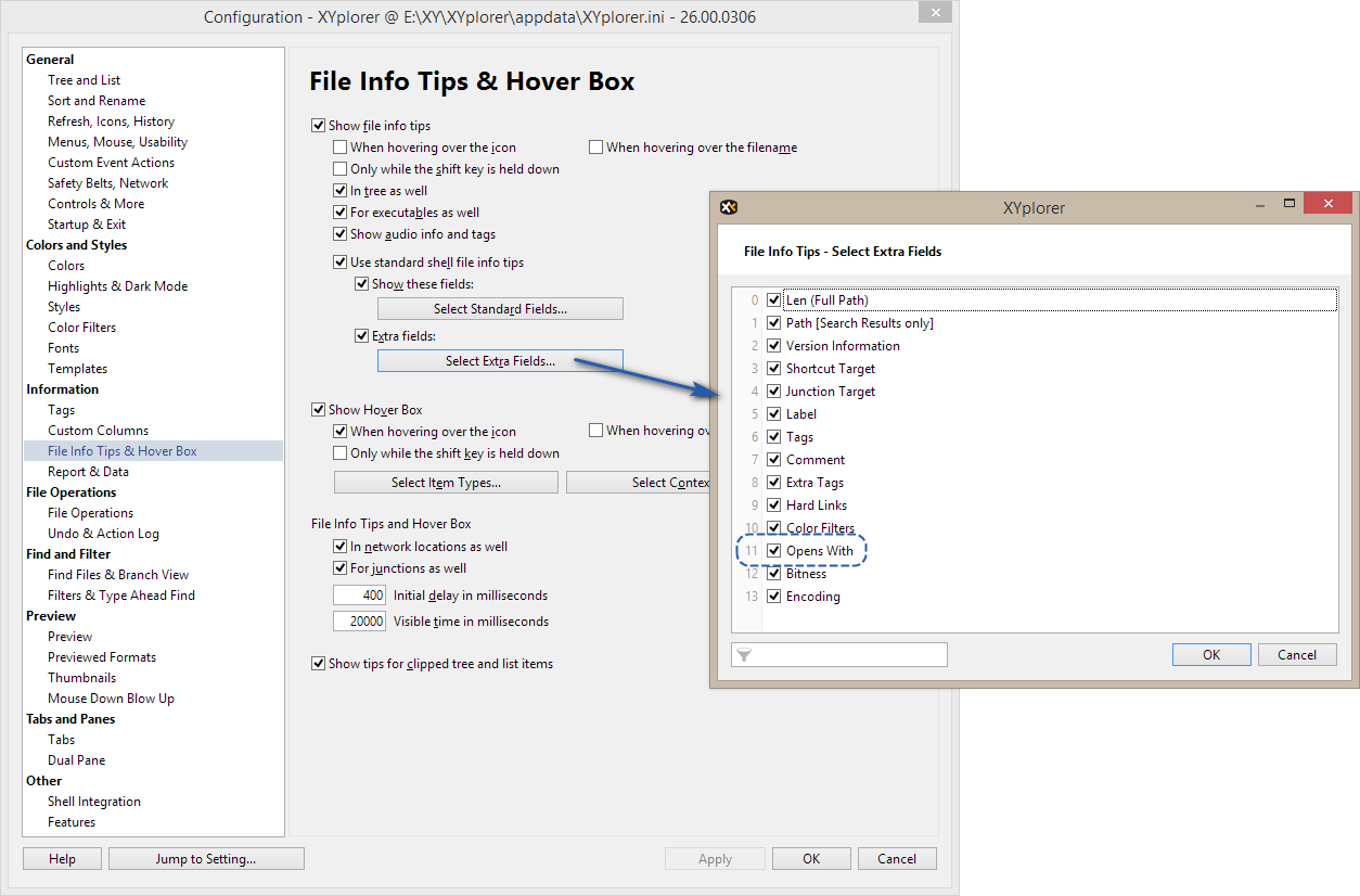

EDIT: Found the setting under Information / File Info Tips, ticked extra fields where it lists the open with field in the selection. It now shows it, and it correctly shows the program it should be opened with as "JPEGview". Added a 2nd screenshot of course.
Posts: 66530
Is the field ticked here?
Creat
Posts: 234
Joined: 22 Sep 2005 18:27
Post by Creat »
It is now, I had just edited my post after I found that :D

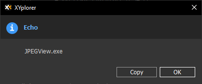

Posts: 66530
Select a JPG file and run this through the address bar:
echo get("assoc", <curitem>);
Creat
Posts: 234
Post by Creat »
Result as it should be, I assume? see screenshot
