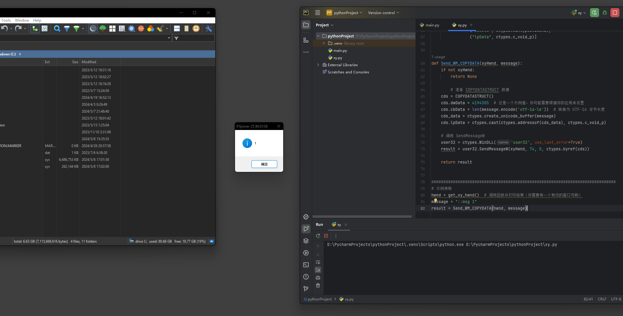

Norn
Posts: 516
Joined: 24 Oct 2021 16:10
Re: Is there any way to apply labels to a folder externally?
Post by Norn »
I installed Python and asked AI to convert an AutoHotkey v2 script into a Python script.

rolander
Posts: 36
Joined: 22 Aug 2022 17:41
Post by rolander »
Brilliant!! Works great.
Using this script I can tag my folders in the background.
Thanks a lot for taking the time to do this :) Really appreciated
