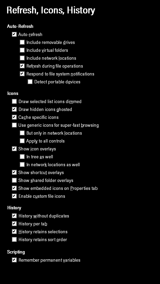

I dont know what happened but for atleast the last week when i try to browse my system drive, nothing displays not until I press ESC. The drive is a fast drive and works fine in Windows Explorer (its a Samsung SSD 980 Pro with Heatsink 2TB) It does this behavior across every folder on that drive.
I first went through all the settings I can find that might relate
Tools....Customize List...Show Folder Size is OFF and here are the other refresh settings I can find:
refresh settings.png (45.8 KiB) Viewed 1455 times
