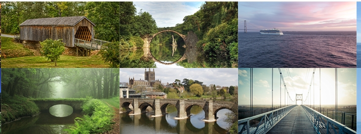

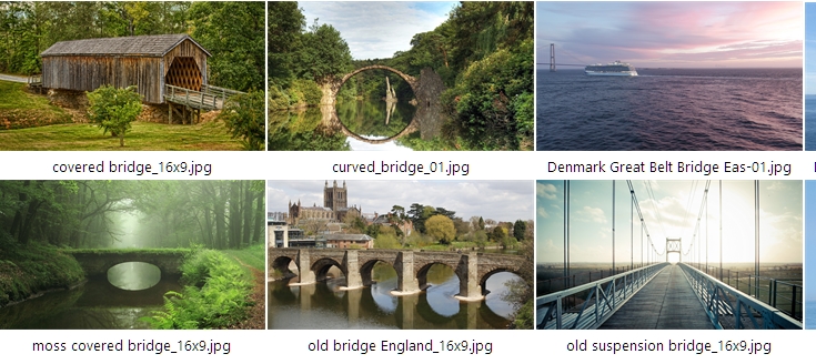

There are so many thumbnail configuration possibilities. You could use a one liner script like the one below in a CTB (Customized Toolbar Button) or in a UDC (User Defined Command) to change your thumbnail view from a gallery mode to a more normal thumbnail mode with the click of a CTB or an assigned keystroke. Copy and paste it to your "Address bar" or in "Run script" to test when you're in a folder of pictures.
  thumbsconf((thumbsconf() == '1,0,0,1,0,0,0,0,1,0') ? '0,1,0,0,0,0,0,0,1,0' :  '1,0,0,1,0,0,0,0,1,0');
  Syntax (see the Scripting command reference in Help:
  thumbsconf([settings="ShowCaption,ZoomToFill,Style,Padding,Transparency,ShowIcon,ShowDimensions,OverlayCaption,FolderThumbs,ZoomToFit"],
gallery wall thumbs.jpg (203.1 KiB) Viewed 532 times
normal thumbs.jpg (240.66 KiB) Viewed 532 times
