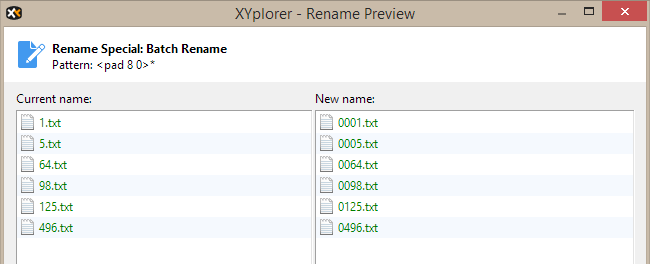

- Posts: 67208
Re: Padding file names with 0
Nice task. In the next beta you can do it using this pattern:
<pad 8 0>*To see the attached files, you need to log into the forum.

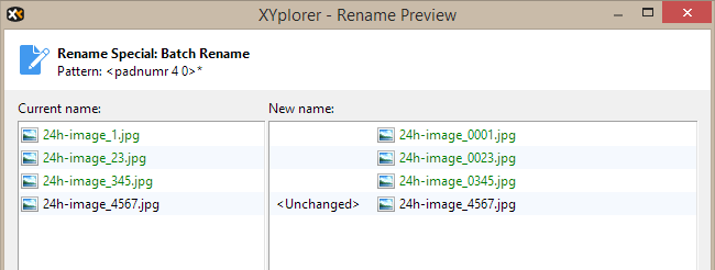

- Posts: 67208
FYI, the next version will do some useful number padding:

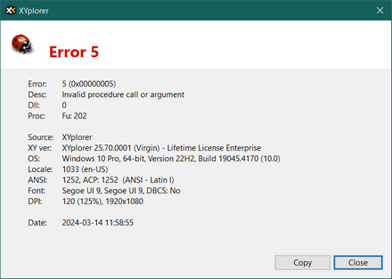

- Posts: 3569
- Joined: 20 Oct 2017 21:14
- Location: Win10 22H2 120dpi
I have noticed a crash can occur if for example you type in the address bar an empty variable and then pad, while this may not be something that people would do intentionally, it could still occur, to repro in fresh,
Enter something like the following in the AB:
My XY even crashes if I just have that string on the clipboard and right click on the breadcrumb bar, which made me crazily test paste and go, which shows an error instead of the crash, not sure if it is useful.
<a><pad 1 XY will crash at this point, same in LF box.My XY even crashes if I just have that string on the clipboard and right click on the breadcrumb bar, which made me crazily test paste and go, which shows an error instead of the crash, not sure if it is useful.
