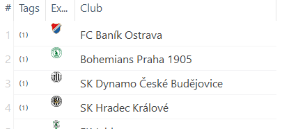

After the latest update (v25.50), the icons in the icon customs column are vertical aligned at the top instead of in the center like before the update. It doesn't look nice in relation to the text next to it.
Can this be fixed in some way?

That's Details view, right? But I cannot reproduce it. Do you also see that in a fresh instance?
Re: Icons customs column not vertical centered anymore
It is indeed in the Details view. The upward alignment unfortunately remains even after XYplorer is restarted.
It is noticeable that it changed after the update. Before this, the icon was nicely centered in the row flush with the text.

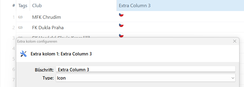

Can you attach one of the icons to your post?
Can you show how that custom column is defined?
What is your screen resolution, 100%, 125%?
My screenresolution is 100%
I tried to to upload an icon (.ico file) i use, but it's not allowed on this forum. So i packed it with winrar. Hopefully that will do.

Thanks, got it. Fixed in next beta.
