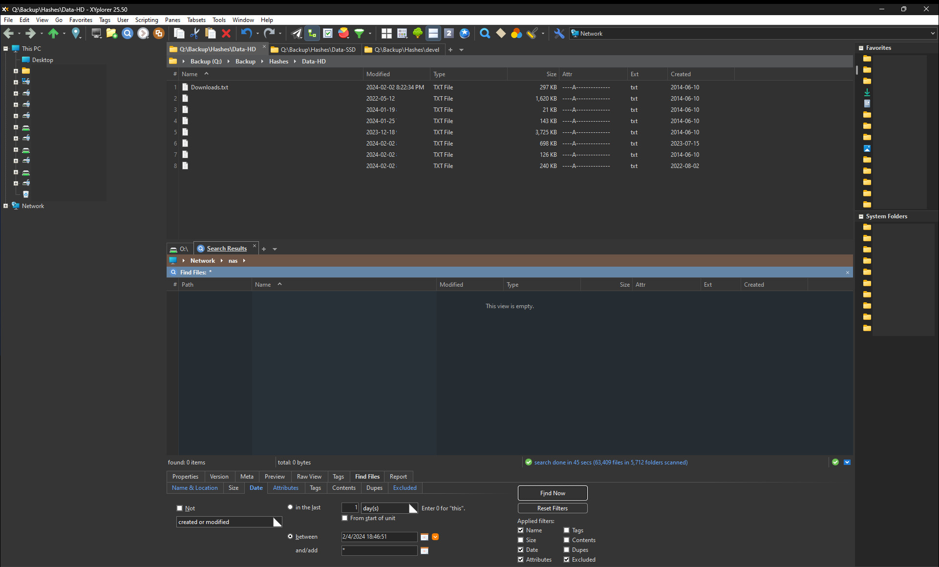

Case in point, I have a two pane configuration, and I use the bottom pane to conduct a search. Then I load a column set consisted of MD5 and full path, and I refresh the MD5 column. After pressing Ctrl+Shift+C to copy the hash/filename pairs, I select the relevant hash text file(s) from the top pane so I can open and copy the new info into them, and since 25.40 at the least, and continuing on into 25.50, the program hangs for 20+ seconds. It changes the cursor to busy-arrow, but it's dead. Clicking in the title bar changes the text to "Not Responding". This is reproducible from run to run. I've been doing this at least weekly for many years, and this behavior just recently started. Any ideas?

Yes. I Left-Click one of the files in the top-pane, so that I can Ctrl-Click the other relevant files, and then I Right-Click to open them from the context menu. I have several of these .txt files based on my groupings, like Downloads.txt, Music.txt, etc. It didn't hang right now when I tried the Left-Click, but I didn't first perform my /search/column set change/refresh column/copy to clipboard/ sequence, either.
ETA: I was going to progress through the sequence and Left-Click after each step to see if there's one that triggers the hang, and the very first step, the search, did. I just performed the search, and the Left-Click on Downloads.txt in the top pane caused it to hang for 30 seconds (I timed it). Trying this sequence a second time in the same instance of XYplorer doesn't cause the problem, but it's reliably reproducible with fresh instances of XYplorer. I also tried waiting 45 seconds after the search to perform the Left-Click, and the 30 second hang is definitely triggered by the Left-Click. And it's not just that file. If I click on another tab in the top pane, it hangs. However, if I click on another tab in the bottom pane, it seems to clear whatever condition is causing the hang, because I can then do stuff in the top pane without getting the hang. So, I seem to be saying that going directly from the search in the bottom pane to interacting with the top pane causes the 30 second hang in a fresh instance of XYplorer.

Sounds weird. Can you provide a screenshot of the entire XY window?

OK, the screenshot is after performing the search and clicking Downloads.txt. The program has hung with the Busy-Working cursor, but it's not in the screenshot, of course. If you need to see that, I took photos in that state and also after clicking the title bar, after Windows appended "(Not responding)" to the title and switched to the Busy cursor.
