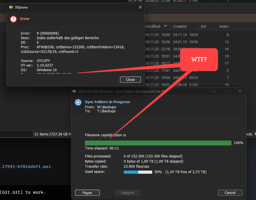

Re: Version 25.xx crashes backing up many folders/files
Is that possibly related?
It's popping up once "Sync Folders" on an already synced target (done with FreeFileSync) reaches 100%.
XYplorer version: 25.20.0106
Error: 9 (00000009)
Desc: Index außerhalb des gültigen Bereichs
Dll: 0
Proc: KFW@338, cntItems=152300, cntItemFolders=15418, i/ubSource=52178/19, cntFound=3
Source: XYCOPY
XY ver: 2.10.0237
OS: Windows 10
Date: 30.11.2023 20:11:44
- SyncFolders_error-9.png (42.53 KiB) Viewed 3038 times
- Posts: 64263
Hmmm. This has probably been going on for a long time, but only recently does XYcopy show this kind of error. I'll check that tomorrow.
BTW, do you often see these layout failures?
- SyncFolders_error-9b.png (51.13 KiB) Viewed 3031 times
Yes, since around beginning of November when I upgraded to Win 11 and I decided to rebuild the target drive "T:" from scratch.
Besides the visuals I noticed a very weird overall behavior wich XYcopy background jobs: the copy dialog every once in a while just vanished and left another "stale" job in the queue. On retry with a given XY session it was like "rinse & repeat", and these jobs accumulated over time as shown when clicking on the "background job queue button" in the status bar.
However, clicking on any job entry did do nothing: no new (progress) popup, no error message - simply nothing. Restarting XY did clear the queue - but just to prepare it for the next round.
I didn't open a bug because to me there was no clear way of reproduction (for instance, is it the file number or the sheer summed size?) and the runtime for a simple test was muuuuuch to high.
I think the origin might be related to
v25.00.0207 - 2023-10-24 22:34
% Heavy Duty Performance: During several tests with huge folders (> 100,000 items),
several bottlenecks were identified and eliminated, i.e. replaced by more efficient
algorithms.
- Posts: 64263
XYcopy shows this kind of errors only since v25.20.0101 - 2023-11-26 13:10. Before it just crashed silently.
You experienced both types of mishaps. Both will end tomorrow.
The layout problem is not related to this AFAICS. I'll put an end to that as well.
