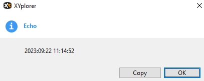

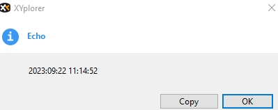

Now with Beta 25.00.0000, there is partial success, but in a completely unexpected way:
[echo get("exif", 0x9003);] is now OK with .DNG [Echo DNG.jpg] - but still gives the "new" error message (in the script window) for .CR2
for the actual command 'Set Created date to EXIF' it is the inverse (??!)
- for .CR2, the correct date is set - as in the stable versions; the temporary dysfunction has been cured
- but not for .dng !! [Timestamp DNG 25.00.jpg]
btw same error for 'Set Modified date to EXIF' - 'Set Modified date to Current' works OK
So now the time_date of the .dng is found, but "cannnot" be applied ...
'png' was just a typo - I never tried with .PNG since they contain NO EXIF data ...

... + the screenshots ...
