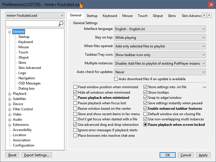

Though i understand this probably won't get high priority, this feature would be useful to come at least in future. Apart from simple "see what you changed" this would allow to "see what is different and maybe causing you problem/bug behaviour". It's really a pain when you migrate your INI into new version, something starts malfunctioning, and you have to manually compare your settings with fresh to possibly find what is the reason. Yet some settings could be changed years ago, so to compare-find such things is a real bother.
Considering how this may look like, here's an example from PoPlayer - its versions come not so often as XY, so each new version marks new/changed settings with bold. Same bold could be used to mark all settings that are changed compared to factory default settings. The option to mark settings could be called say by right-click on Help button in Configuration.
