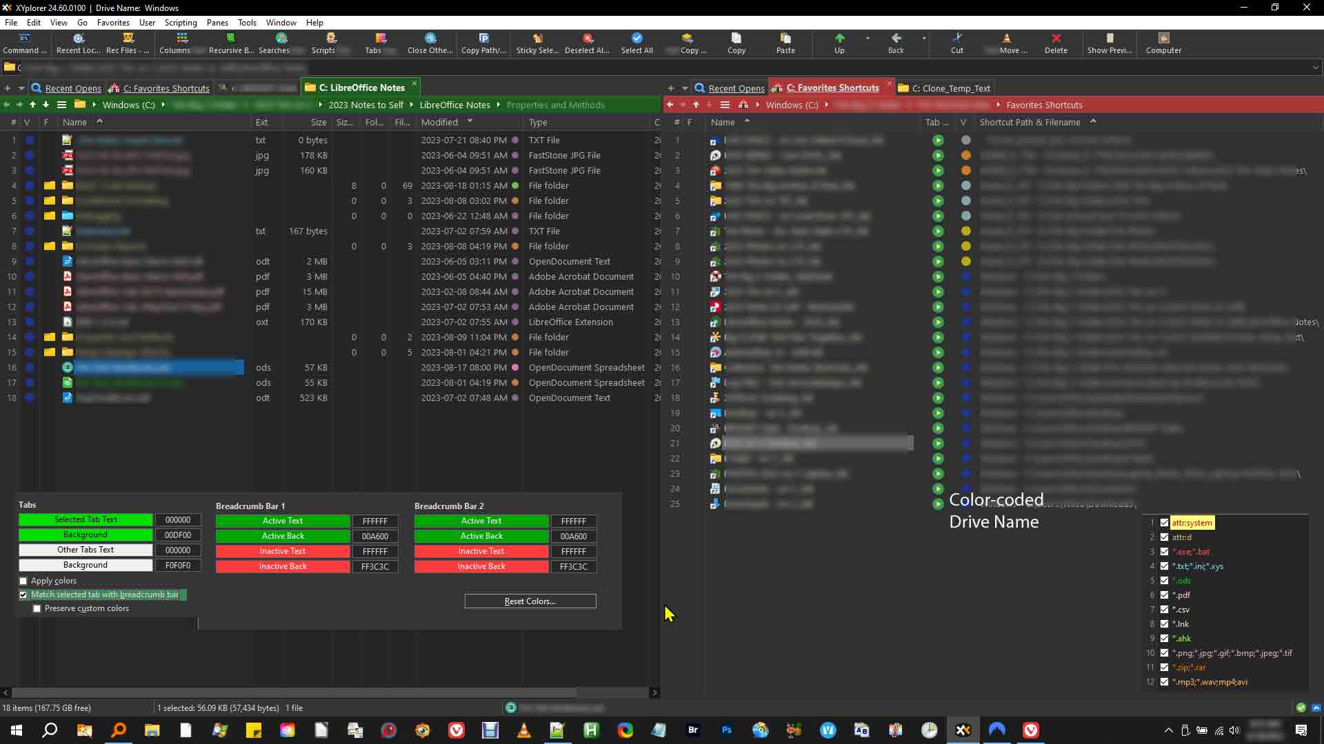

Here is a screenshot of my XYplorer window:
As you see, I use color coding for everything. From filenames to the breadcrumb bar + active tab. Via colors, it should be instantly obvious which is the active pane and active tab versus the inactive pane. GREEN means active, RED means inactive. And those colors toggle back and forth depending on which pane is active at the time.
I also use color-coded circles in a custom column to show which drive name a file is located on. Or in this example on the right-side pane, which drive name a shortcut points to.
You already know the usefulness of color coding which is why you made it extensively possible to use colors for filenames, and why you currently have color choices for inactive and active breadcrumbs bar available in Configuration. You just haven't extended that to scripting yet so it can be used dynamically.
COLOR COMMUNICATES INFORMATION. And as you see on my screenshot, the breadcrumb bars are big, bold, colorful real estate on the screen that can be used to communicate information. In an unmistakable way. Currently mine communicate active (GREEN) versus inactive (RED). My first use for dynamic color coding would be use (YELLOW) in the script I use to activate 'Sticky Selection' and then back to regular color in the script I use to de-activate 'Sticky Selection'. That way it is unmistakable whichever state 'Sticky Selection' is in. And when it needs to be turned off.
But once available, other communication could be delivered with color coding that screen real estate. The status of a copy operation, for example. Or the identity of the drive that is being used. Basically, anything that could be toggled at the beginning or end of a script-- or elsewise in scripting. That is a lot of valuable screen real estate. Its color can be put to use.

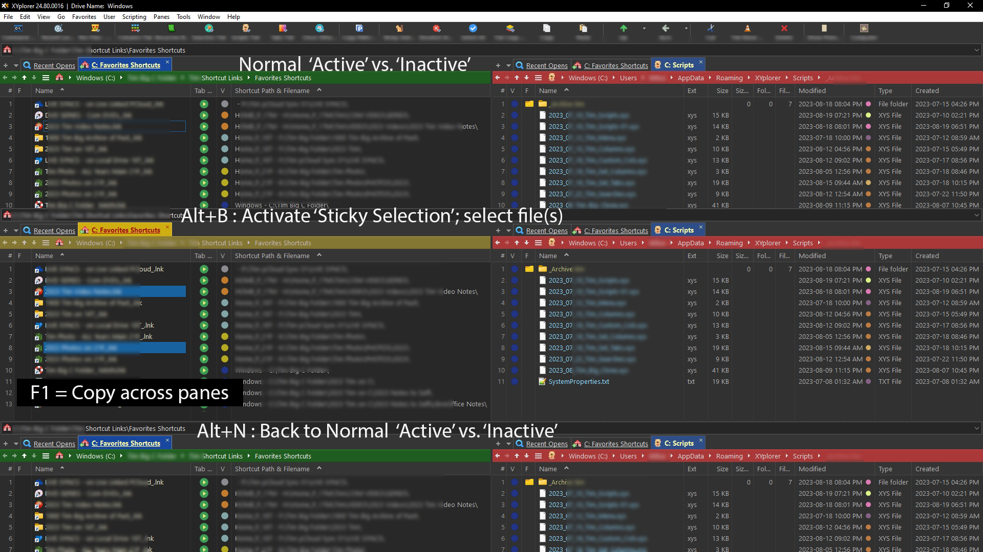

Just tried it.... works like a charm!admin wrote: ↑19 Aug 2023 16:55 It's in the recent beta version. Did you already try it? --> viewtopic.php?p=213465#p213465
Here is the code:
// 2023_08_19_185158
// Sticky selection
// Keyboard Hotkey: Alt+B
// Load "2023_07_10_YYY_Scripts.xys", "StickySelect"
"Sticky Select current item in list : StickySelect"
$a = get("#413"); // determine if 'Sticky Selection' state is currently active
switch ($a) {
case 0: // If Sticky Selection is not active then toggle it ON
sel "+0",1,0 ; // Select the current item if it is not actively selected
#413; // Toggle Sticky Selection ON
break;
case 1:
break;
default:
break;
tab("backcolor", "F4CB0D"); // set tab backcolor to YELLOW
tab("textcolor", "AA1111"); // set tab text to RED
// AT1,AB1,IT1,IB1,AT2,AB2,IT2,IB2 (A=Active,I=Inactive,T=Text,B=Back,1=Pane1,2=Pane2)
interfacecolors(",F4CB0D,,,,F4CB0D,,", 3); //modify the background colors of the breadcrumb bars (YELLOW)
interfacecolors("AA1111,,,,AA1111,,,", 3); //modify the text colors of the breadcrumb bars (RED)
// *** Use Keyboard Hotkey: F1 to initiate a Copy of files between the two panes ***
// 2023_08_19_191109
// Toggle Sticky Selection OFF and De-Select All files (clean slate)
// Keyboard Hotkey: Alt+N
// Load "2023_07_10_YYY_Scripts.xys", "UnSelStickOFF"
"De-Select All Files + Sticky Sel OFF : UnSelStickOFF"
switch ($a) {
case 0: // If not currently active then do nothing
break;
case 1: // If it is currently active then...
#413; // Toggle Sticky Selection OFF
break;
default:
break;
sel ; // De-Select ALL items
tab("backcolor"); // re-set tab color to normal
tab("textcolor"); // re-set tab text color back to normal
// Current 'normal' breadcrumb bar colors: Active text FFFFFF Active back 00A600 Inactive text FFFFFF Inactive back FF3C3C
interfacecolors("FFFFFF,00A600,FFFFFF,FF3C3C,FFFFFF,00A600,FFFFFF,FF3C3C", 3); //re-set the colors of the breadcrumb bars back to 'normal'
When I am using the computer in an office or properly lit environment it may not matter much, but when I have the laptop out with me in the field and am trying to use it to copy files with broad daylight making the screen hard to see what I am doing (especially for trying to use the mouse, etc.) this is now an all-keyboard way to select multiple files and copy them over to the other pane. Even if I can't see the screen very well because of the (too bright) lighting I should still be able to make out what I am doing and not make too many mistakes trying to copy the files. All keyboard. No mouse.
THANK YOU!!
