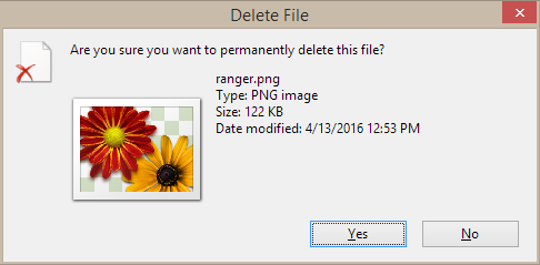

Anyway, When I delete an item from a mapped drive (Win 8.1), I get this prompt and it tells the truth. The deletion will be permanent:
- 2023-05-13_101540.png (24.98 KiB) Viewed 1904 times
