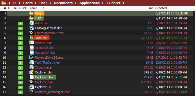

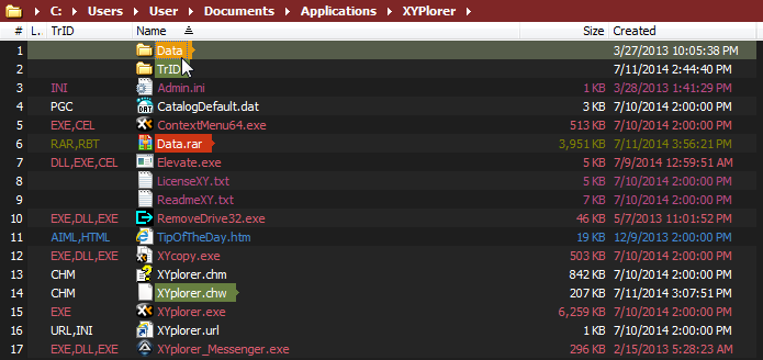

Now you have two flavors of custom column to use. The first simply takes the result of the file identification and put them into the column from the most likely file type to the least likely file type. Basically "JPG,MP3" means it's most likely a JPG file and while it has characteristics of an MP3 file, it's lower than a JPG. It's always best to actually use the custom toolbar button or the custom column flavor below to get actual percentages of the possible file types since anything after the 1st possible file type could have very low percentages but the script will still display them.
Alternatively, you can have the custom column with clicking feature. With this, it's a bit easier to test each file by simply clicking the Play button rather than mouse travel all the way to the custom toolbar button and back.

How can i have the two columns named "TrID" and "TrID Click" like in the images above?
Posts: 14671
Re: [SCRIPT] Identify File Types Using TrID - July 11, 2014
Right click on empty column header, Add Column
Right click that new column header, Select Custom Column...
Double click on an "(Undefined)" entry
Right click that column header again, Configure Custom Column <x>...
Enter the script and look at the rest of the settings...
For the same but with "Click", change the Trigger: to "Click" instead of "Browse"
$result = runret(lax("<xypath>\TrID\TrID.exe" "<cc_item>"), "%TEMP%", 65001);
    if (strpos($result, "Unknown!") != -1) { return "Unknown"; }
    $types = regexmatches($result, "(\(\.[A-Z0-9/]+?\)|\(\.\)[^(]+)", <crlf>, 1);
    $types = regexreplace($types, "(\(|\)|\.)");
    // Remove duplicates
    $final    = "";
    $existing = "|";
    foreach($type, $types, <crlf>, "e") {
        if (strpos($existing, "|" . $type . "|") == -1) {
            $type      = trim($type);
            $final    .= $type . ",";
            $existing .= $type . "|";
    return trim($final, ",");
