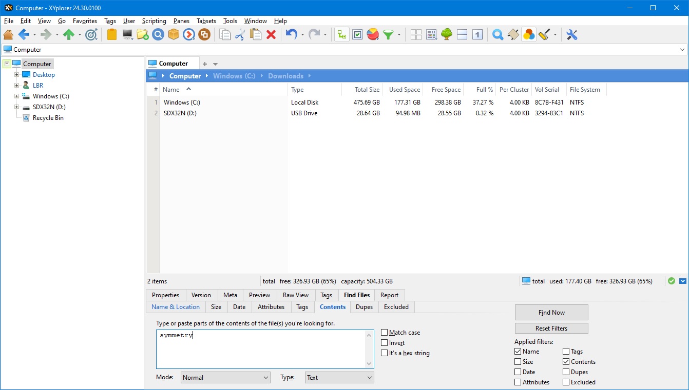

When doing a plain text search over the entire "C:" volume
XYplorer V24.30.0100 repeatedly reports "Error 11 Division by zero".
The attached file "XY_V24.30.0100_Find_Dialog_1.jpg" shows
what was specified in the "Find Files" dialog.

Re: Error 11 (Divide by Zero) When Doing a Plain Text search
Send me one of those EML files that trigger the error.
