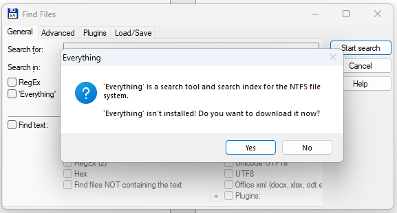

Someone did mention that TC has a built-in Everything integration.
download/file.php?id=19106
That's probably a lot of work, and I am actually quite happy with the way things are right now.
