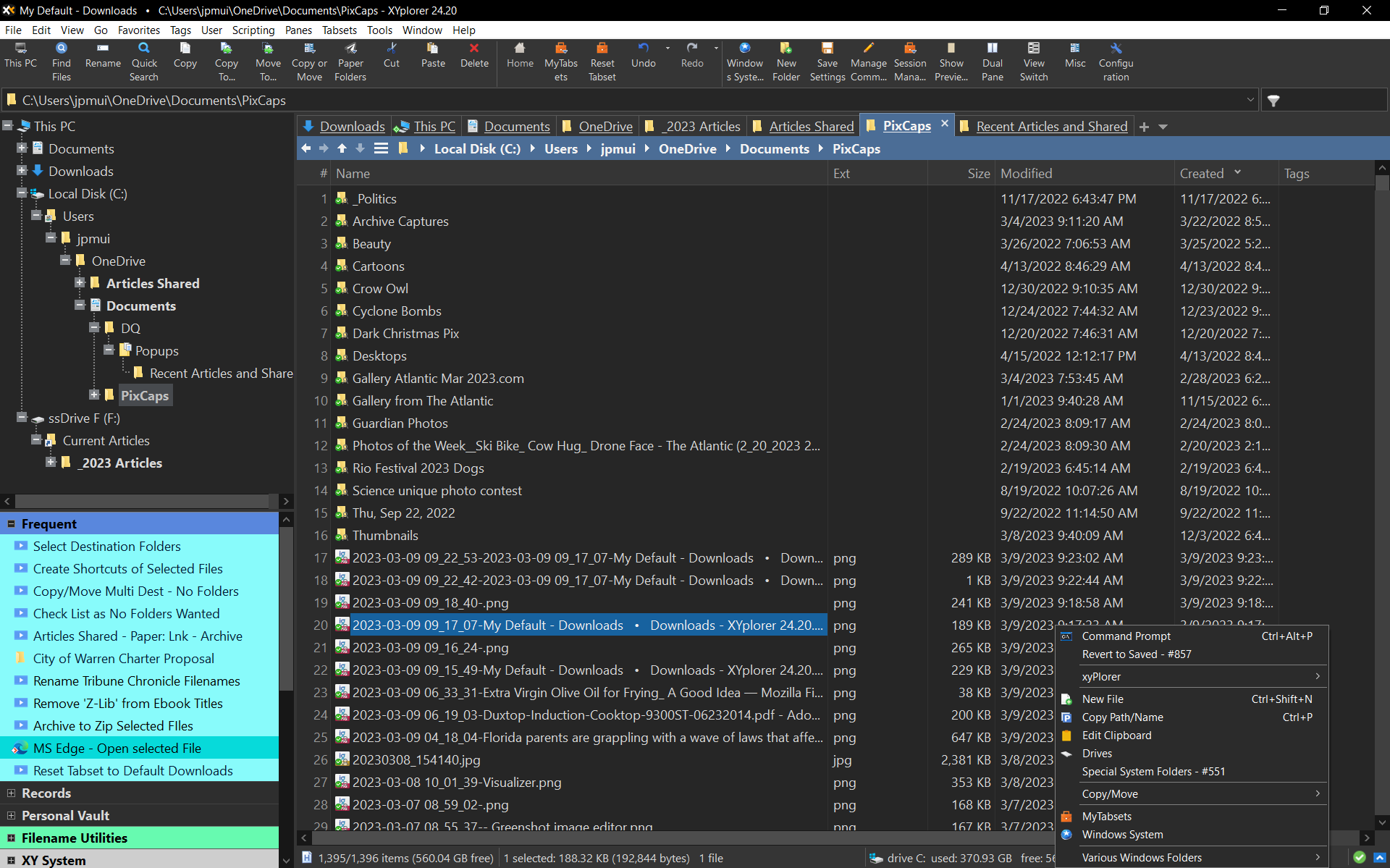

When I open XYplorer on the laptop screen Monitor 1, (1920 x 1080) - I get a predictable popup location beneath my "Misc" button on the toolbar as expected, right under the button.
Monitor 1 (Laptop Screen) 1920x1080 screen pic of XYplorer popup correct
2023-03-09 09_18_40-.png (240.52 KiB) Viewed 1757 times

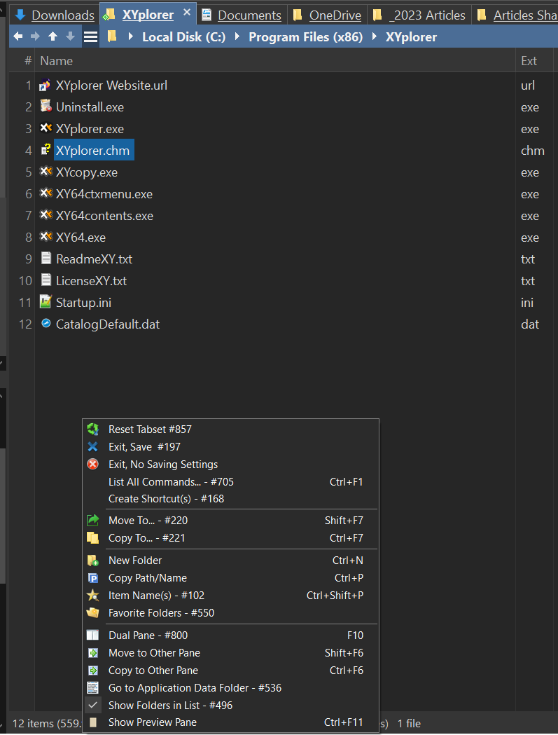

When I open XYplorer on my second Monitor 2 which is a larger monitor with 1920 x 1200, the popup opens only at the bottom of the XYplorer window. I also tried setting Monitor 2 to a setting identical to 1920 x 1080 to see if that makes a difference, and it did not, the popup opened at the bottom. Also adjusted scale and layout from 125% to 100% and no change on the position of the popup at the bottom.
Monitor 2 (HNC monitor) 1920x1200 screen pic of XYplorer popup at bottom
2023-03-09 09_23_40-.png (243.75 KiB) Viewed 1757 times
Is there something else I might try. I use the 2nd monitor mostly when I'm processing curated files and I'd like to use a button to organize some of my "moveto" utilities within the button

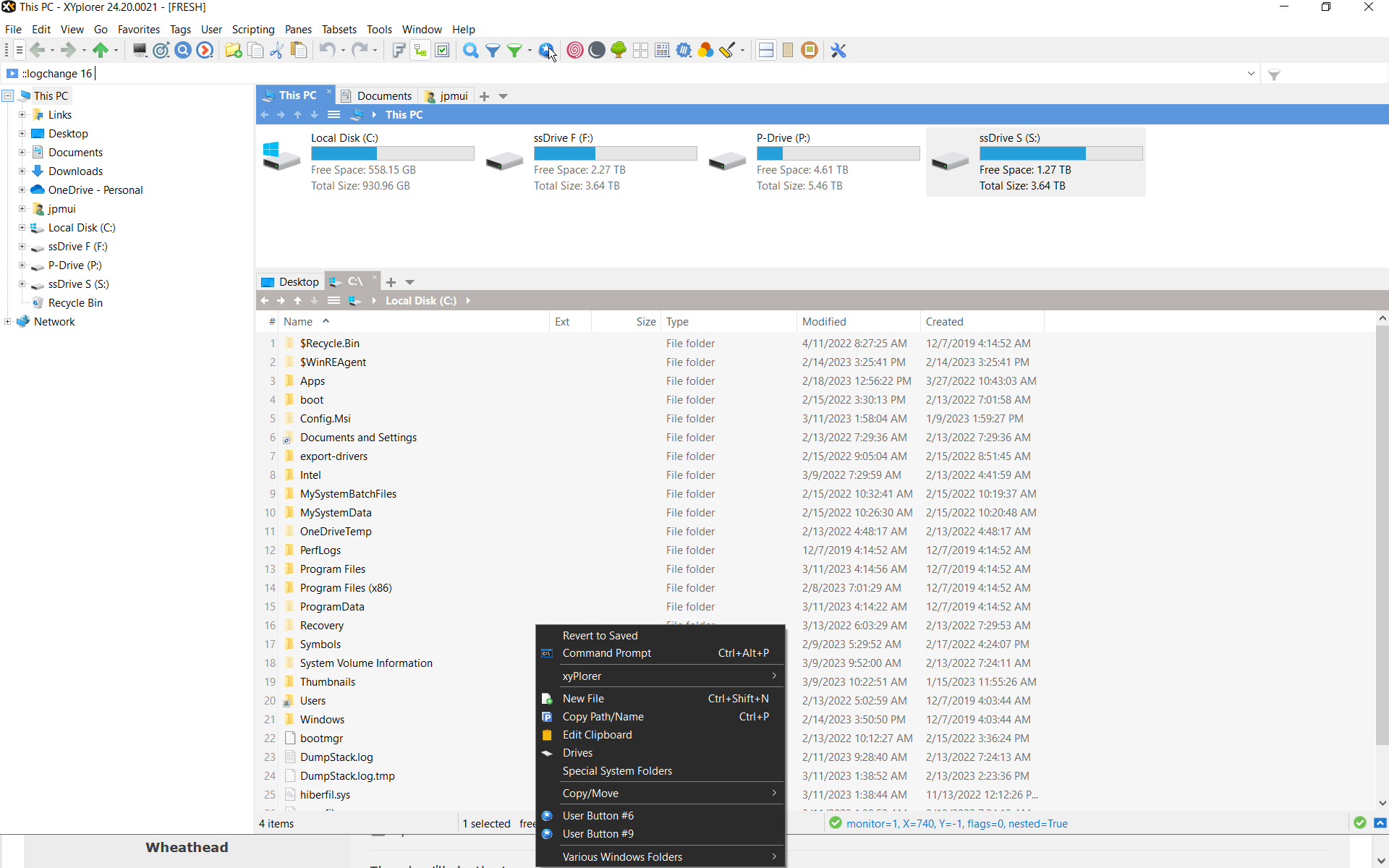

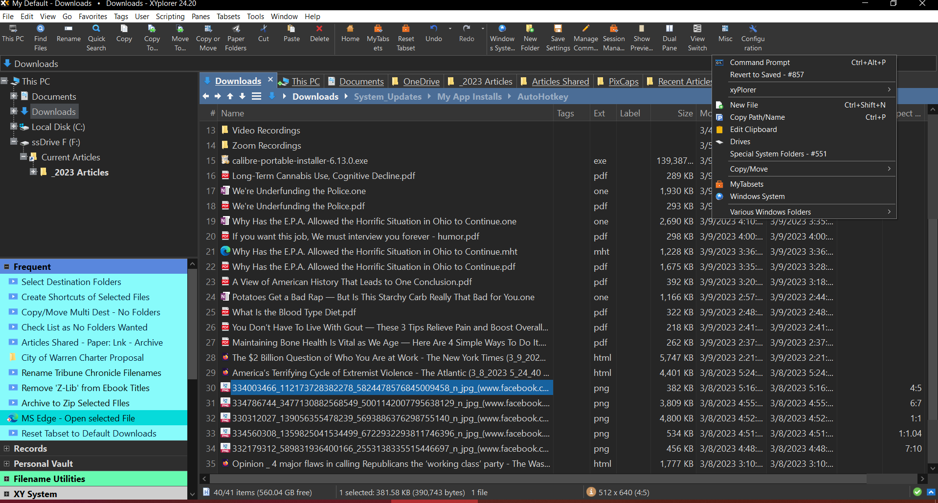

Using Monitor 2, HNC Monitor above Laptop
1. For Monitor 2 using the OpenWith toolbar button where the popup emanates from the toolbar button at the top:
Monitor — OpenWith toolbar button
monitor=2, X=57, Y=-1080, flags=0, nested=False
2. For Monitor 2 using my own Misc toolbar button where the popup emanates from the bottom:
Monitor 2 — Misc toolbar button
monitor=2, X=1514, Y=-1, flags=0, nested=True
Using Monitor 1, Laptop screen —
1. For Monitor 1 using OpenWith toolbar button,
monitor=1, X=57, Y=120, flags=0, nested=False
2. For Monitor 1 using my own Misc toolbar button the popup emanates from the toolbar button at the top as designed:
Monitor 1 — Misc toolbar button
monitor=1, X=1514, Y=120, flags=0, nested=True
