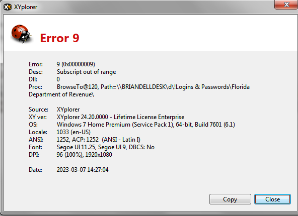

Hi All,
You may view my previous post here: viewtopic.php?t=25827, which detail my previous two "Error 9 Codes" - that last (before today's) was just yesterday, March 6 (details posted at end of post). I started this new post because it seems I was no longer getting any replies/help on the original post.
Here is my post for today:
Received another "Error 9" message - second day in a row.
Below, please find the error details, as copied/pasted from the XYplorer error reporting part of the program. I am also pasting/attaching a PNG screenshot of the error 9 code at the end of this message.
Any suggestions, help of troubleshooting would be much appreciated, as this is now becoming a daily occurrence.
Thanks so much for your help and advice.
Thanks,
-Cfguy
Text of Error 9 Code 03/7/2023 at 02:27 PM. EST:
Error: 9 (0x00000009)
Desc: Subscript out of range
Dll: 0
Proc: BrowseTo@120, Path=\\BRIANDELLDESK\d\!Logins & Passwords\Florida Department of Revenue\
Source: XYplorer
XY ver: XYplorer 24.20.0000 - Lifetime License Enterprise
OS: Windows 7 Home Premium (Service Pack 1), 64-bit, Build 7601 (6.1)
Locale: 1033 (en-US)
Font: Segoe UI 11.25, Segoe UI 9, DBCS: No
DPI: 96 (100%), 1920x1080
Date: 2023-03-07 14:27:04

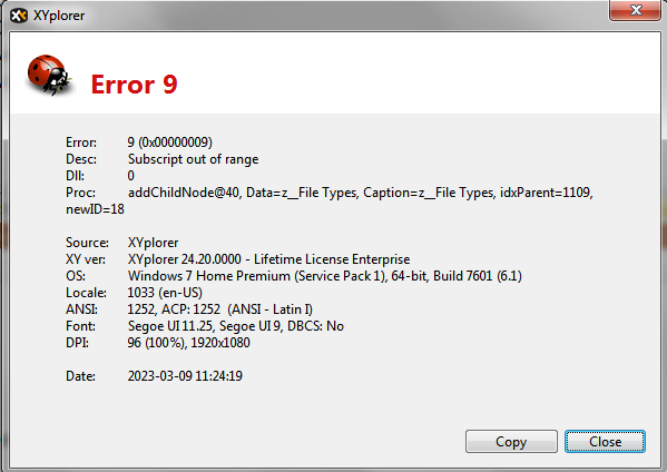

Hi All,
Apologies for not having seen previous message requesting screenshot of "tree" when Error 9 error occurs.
I did receive another Error 9 error yesterday at 11:24 AM, EST. I was pressed for time yesterday, so did not get to post information here immediately, however I did save error message, take screenshot of error message (attached, for your reference), and also took a screenshot of XYplorer "tree" (attached, for your reference) immediately after the Error 9 error occurred, sand saved it all so that I could post at a more convenient time (this morning). I redacted any user information or user photos in the XYplorer "tree" screenshot (for privacy purposes) before attaching. Also, the top frame of the XYplorer "tree" is of a "networked drive", and I notice that XYplorer is duplicating each directory in the particular folder on the networked drive (this has happened to me on other occasions, as well, without receiving any error messages). In the meantime, below please find the clipboard text of the error pasted below, as well as screenshots of the error (when it occurred) and, as requested, the XYplorer directory tree in its current state when the error occurred (with some user information redacted) inserted at the end of this message, and attached, as well.
As always, thanks for your help, and I will check back to see what steps you feel I should take next.
Thanks,
-Cfguy
Text of Error 9 Code 03/09/2023 at 11:24 AM, EST:
Dll: 0
Proc: addChildNode@40, Data=z__File Types, Caption=z__File Types, idxParent=1109, newID=18
Source: XYplorer
Date: 2023-03-09 11:24:19
Posts: 66582
Re: Need Help - Error 9 Codes Now Daily Occurrence ...
The screenshot of your tree reveals what I suspected, only in a far more extreme degree: Your tree is completely gaga! Didn't you see that??? Didn't you think that it might be worth mentioning? No idea how you managed to arrive at this chaos. How does the tree look in File Explorer? Got a screenshot?
PS: Or is that chaos a result of your whitening out certain words in the screenshot?
Whatever, the crucial part is: idxParent=1109, newID=18
As I said before, idxParent MUST always be smaller than newID. Just from looking at the code I cannot see a way how to reach to the opposite. But obviously there is one. Maybe some circular references (junctions?) in your special folders?
This is obviously a unique case, and I just don't have the time for it. It will take hours or more to get to the bottom of this. Sorry, this is simply beyond my job definition. :|

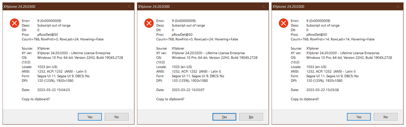

Posts: 3462
I have now seen these errors happen a few times in different instances, I am just browsing not creating a new folder etc, since the OP abandoned the thread, if there is something I can answer or do to debug, let me know.
Posts: 66582
It would help to see these messages in a readable size. ;)
But never mind, I could decipher them, and probably fix the bug. 8)
