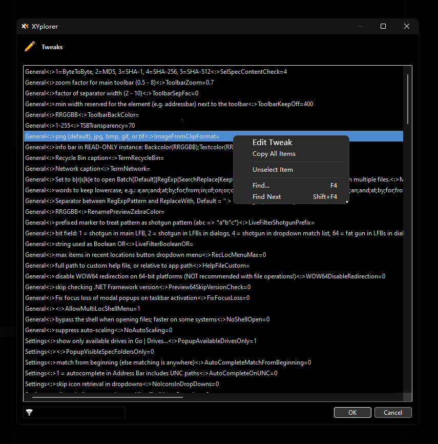

Here is my tweak editor it has taken since november as been so busy.
There is problems with it but it does do the basics.
mazot
- Posts: 48
- Joined: 20 Apr 2020 23:19
Re: Built-In Tweak Editor
I have since tried it on my laptop and found I had not fixed certain things
here is the updated script. Had not informed you that to have the tweak to run it must be from the tweaks section.
It only copies any tweaks you select from "full" to the "tweaks" inisections in script folder.
