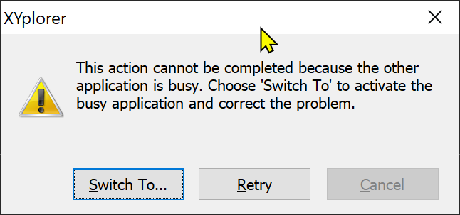

I started getting this error about a month ago (May 2021.)
The only thing I can do is End Task via the Application Manager. This is very frustrating. I am merely browsing directories when this happens. Very intermittent - but when it does happen - it begins to occur much more frequently until I restart the computer. Then I don't get the error for a while.
Running most current versions of XYplorer (v22.00) and Windows 10
"This action cannot be completed because the other application is busy. Choose 'Switch To' to activate the busy application and correct the problem."

- my Xyplorer Error Screenshot.png (20.28 KiB) Viewed 4688 times

Windows introduced this some time ago. The conditions are vague. The documentation is zero. It seems to be related to mouse activity (clicks) while the app is still busy with other stuff. So the workaround is: click a little later.
