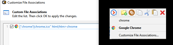

Icon not showing in CFA
It seems to be a problem only with Chrome
|"chrome1|chrome.ico" html;htm > chrome
|"chrome2|chrome.ico" html;htm > notepad

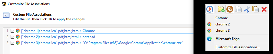

Re: Icon not showing in CFA
that is weird
- Posts: 66981
Could it be the case? Try both chrome and Chrome.
omid
- Posts: 23
- Joined: 15 Mar 2018 17:00
No, I tested it, the result is the same as before
- Posts: 66981
Then Chrome is not registered correctly in the 32-bit branch of the registry. (But here in Win8.1 it is.)
- Posts: 66981
Try without spaces:
|"chrome1|chrome.ico" html;htm>chrome

Not only the icon is missing but also the text "chrome1" is changed to "chrome"
- Posts: 66981
It should not make a difference. Fixed in next beta.
My mistake, I thought you were referring to text.
There is still a problem with the text display.
- Posts: 66981
That's on purpose: If the file reference does not work ("chrome") then you get no custom text / icon. That should tell you that something is wrong here.

- Posts: 66981
FYI, in the last beta (v23.60.0006) I added a (not officially documented) way to find out whether a nick name (aka "ProgID") like "Chrome" actually works:
On my system it returns "C:\Program Files (x86)\Google\Chrome\Application\chrome.exe".
echo get("assoc", "Chrome", 2); FAQ | XY News RSS | XY X
