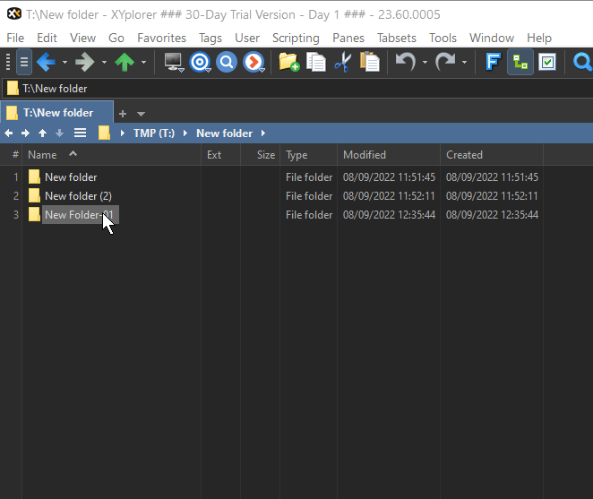

Re: Click rename behavior when giving focus back to XYplorer window
The problem now with 23.60.0006 is that if you change your mind about popping the context menu, and click on the filename, it starts an inline rename. I know that's what happens in File Explorer too, but it's not ideal.
So, with 23.60.0006, after popping the context menu, you can either: (a) click in whitespace to remove the selection, or (b) click again on the filename to start an inline rename.
I think that (b) should rather be that you've changed your mind about the context menu, and just want to go back to having the file selected.
An even better illustration of this problem is if you have multiple files selected, pop the context menu for them, change your mind, and then click on any of the files. Desired behavior would be to go back to having the files still selected. What happens in 23.60.0006 is that just the file you clicked on becomes selected.
