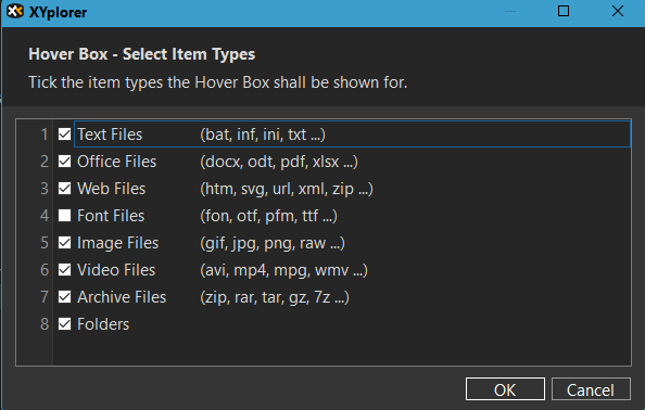

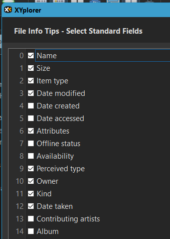

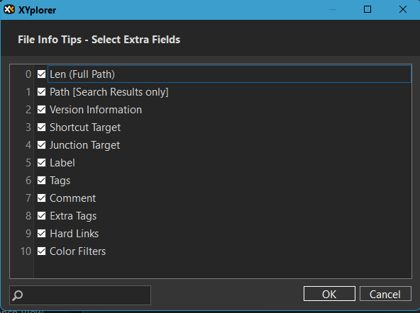

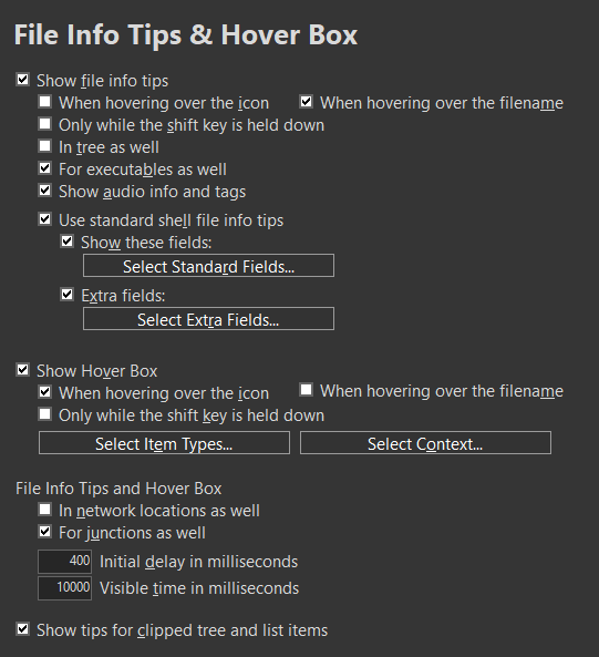

Here my config
Screenshot - 04.09.2022 , 15_01_15.png (23.17 KiB) Viewed 839 times

So, looks like your File Info Tips show pretty much. But it's not triggering the download. Well, let's wait for the other guy's info...
