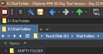

Toolbar Button Sets - 01.png (12.57 KiB) Viewed 2118 times
However, as can be seen from the 1st picture; the number is too small. Is there any problem here?

No the text size is normal, to increase it you would zoom your toolbar with Ctrl+Wheel over the button, or use the Customize Toolbar dialog.
