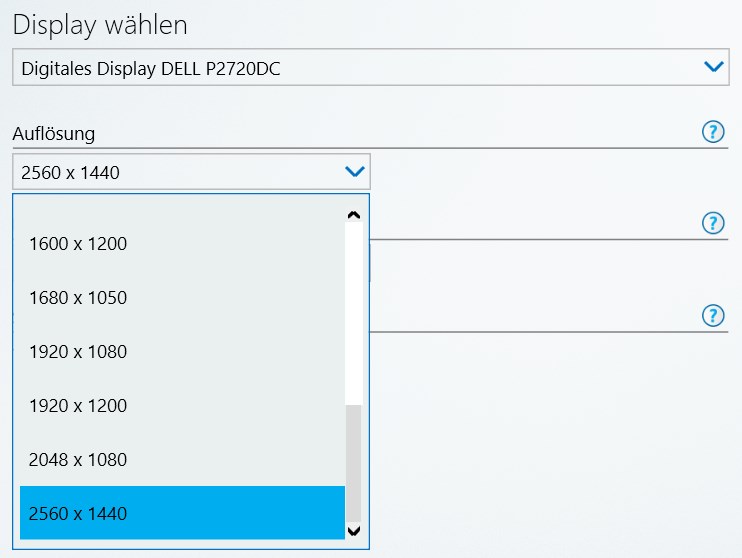

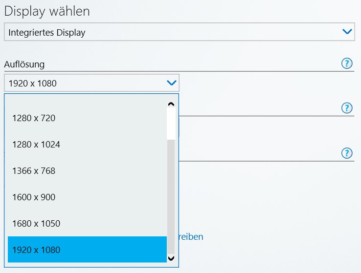

I work with 2 displays with a different resolution (laptop: 1920x1080, external monitor: 2560x1440) in extended mode (as shown in the attached file).
XYplorer remembers which of both displays/desktops was last used for the application window but also for the "Configuration"-window ("Tools --> Configuration" or "F9").

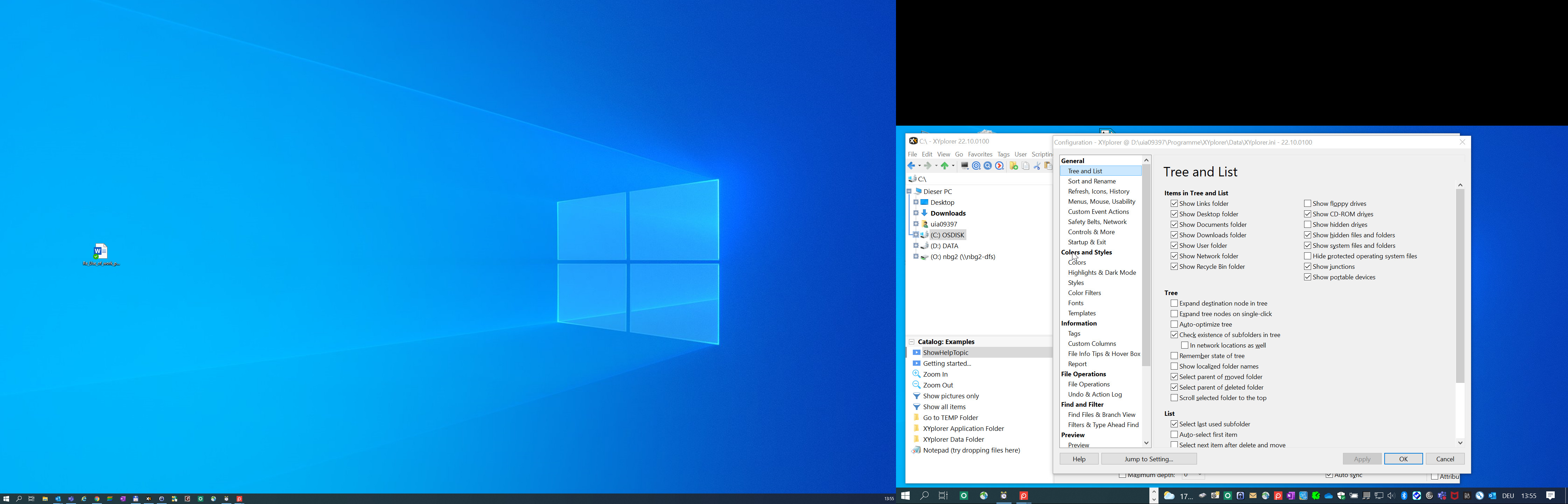

I also attached a screenshot which shows the effect:
a. application window + configuration window are both on the laptop screen
b. application window is moved to the external monitor and configuration is re-opened
The configuration window is much higher
--> window title not visible anymore to move the window
--> Buttons "OK" and "Cancel" often completely invisible to close the window by mouse
