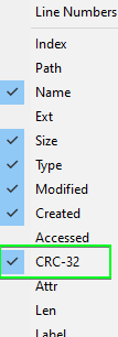

I have a custom column to calculate and display the CRC-32 checksum of a file by clicking the small green icon. It looks like this:
Problem: after updating to 22.70, clicking the green icon no longer calculates the checksum, it just does nothing. It's the same in v22.70.0100 and v22.70.0101 BETA. When rolling back to v22.60.0200 it works again. I didn't change any other settings.
Thanks.

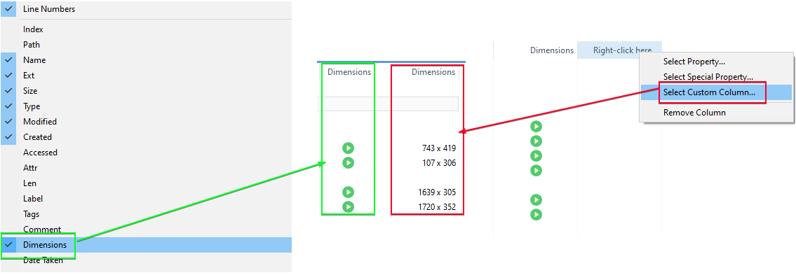

Here's another example: I have the factory default "dimensions" custom column, the only thing I changed was setting the trigger from "browse" to "click".
The left dimensions column (aka "Custom 1: Dimensions") was added by selecting it from the column bar drop-down menu. Clicking the green icon does not trigger the display of the dimensions.
The right dimensions column (aka "User-Defined: Dimensions") was added via right-clicking the column bar -> "Add column" -> "Right-click here..." -> "Select custom column..." -> "Dimensions, Special Property (png;gif;bmp;ico;cur;{:Photo})". In this case clicking the green icon does trigger the display of the dimensions as intended.
Cheers.
Posts: 65351
Re: Custom column broken since v22.70
Good analysis, I saw it now. :tup: Fixed in next beta.
