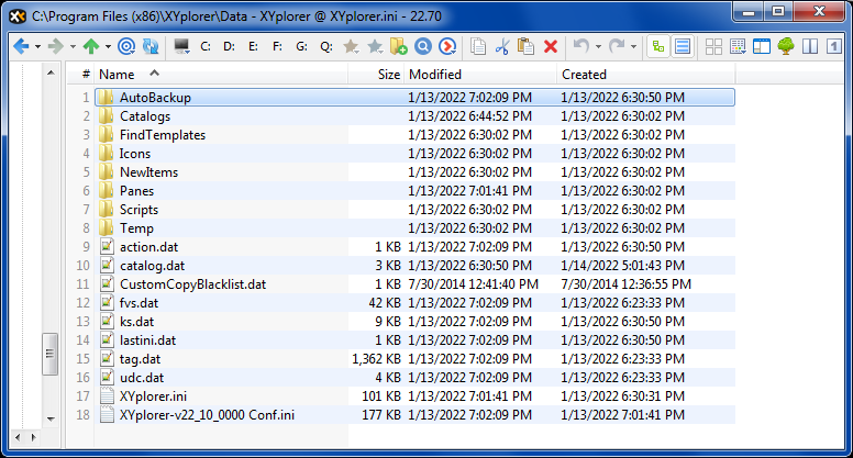

Here is what I am showing:
XYp x86 Prog Fldr.png (36.79 KiB) Viewed 3819 times

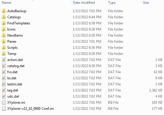

And here is what is in the data folder:
xyp Data Fldr 002.png (30.8 KiB) Viewed 3819 times
I realize the two config.ini files in the Data folder may be in the wrong place? I have moved them around at different times.
Where SHOULD the config files be? Should they be named something else?
The one named XYplorer.ini is the one that has my my license info in it The other one is an ini that I did a Save As from the File menu as a backup when I was using ver 22.10.0000 and was the one that showed up in the Title Bar as being used when I would start the program before the PC lockup. But, it doesn't have my license info showing in it.
Are there any other .dat files that should be showing in the Data folder?
For a basic installation should Startup.ini contain anything other than
[Appdata]
Path=%APPDATA%\XYplorer
I may have a few follow-up questions after I get the basics set back up. If I wasn't for all of the tags, labels & comments I have for a BUNCH of files I would just uninstall and start over.

PeterH
Posts: 2826
Joined: 21 Nov 2005 20:39
Re: HELP Please with XYPlorer After PC Crash
Post by PeterH »
startup.ini defines where the xydata folder is. So ok.
(*Must* point to a folder XY is allowed to modify.)
You talk about 2(!?) config.ini - what do you mean?
The main configuration file of XY is XYplorer.ini
I don't know of a config.ini
Your "XYplorer-v22_10_000 conf.ini" seems to be some hand-made copy (to save something?)
Posts: 14638
CustomCopyBlacklist.dat belongs in the data folder
The rest looks ok

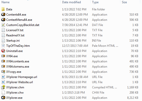

PeterH... In my earlier post I used the term config.ini improperly. It was meant to mean the two .ini files in that folder that contain the configuration information for the program. There isn't one just named config.
Here are two screenshots of what I have now. Main XY then Data folder.
XYp 1-16-22 139P.png (80.95 KiB) Viewed 3783 times
XYp Data Fldr 1-16-22 147p.png (80.27 KiB) Viewed 3783 times
When I started XYp it came up with the above screen. Except it was only displaying the Name column. I added the Size, Modified and Created for the screenshot.
Notice the Menu bar is not displaying (File, Edit, View etc). I have searched through the settings, help file and user guide for "Menu", Show Menu", "Toggle Menu" and a number of other keywords. I am not seeing anything. How can I get it to show? I even re-booted to make sure there were't any old whatever could still be in memory.
I am happy to say that my tags, labels, comments and Catalog are back in tack. :D
But my folder view settings, favorite files, favorite folders and tab settings are still missing. I added Favorite Folders and Files to the Toolbar but they do nothing when clicked. Not sure if I am missing another .dat file with those if that is where they are stored?
If I could get the Menu Bar back maybe I could load an old saved setting and get them back.
Any recommendations for getting the Menu Bar back?

Posts: 3304
The contents of your Data folder should be in the path that was shown in the screenshot you provided of Startup.ini, it looks like you have some files in the wrong spot so half your config is in the wrong folder, it shouldn't be under Program Files.
