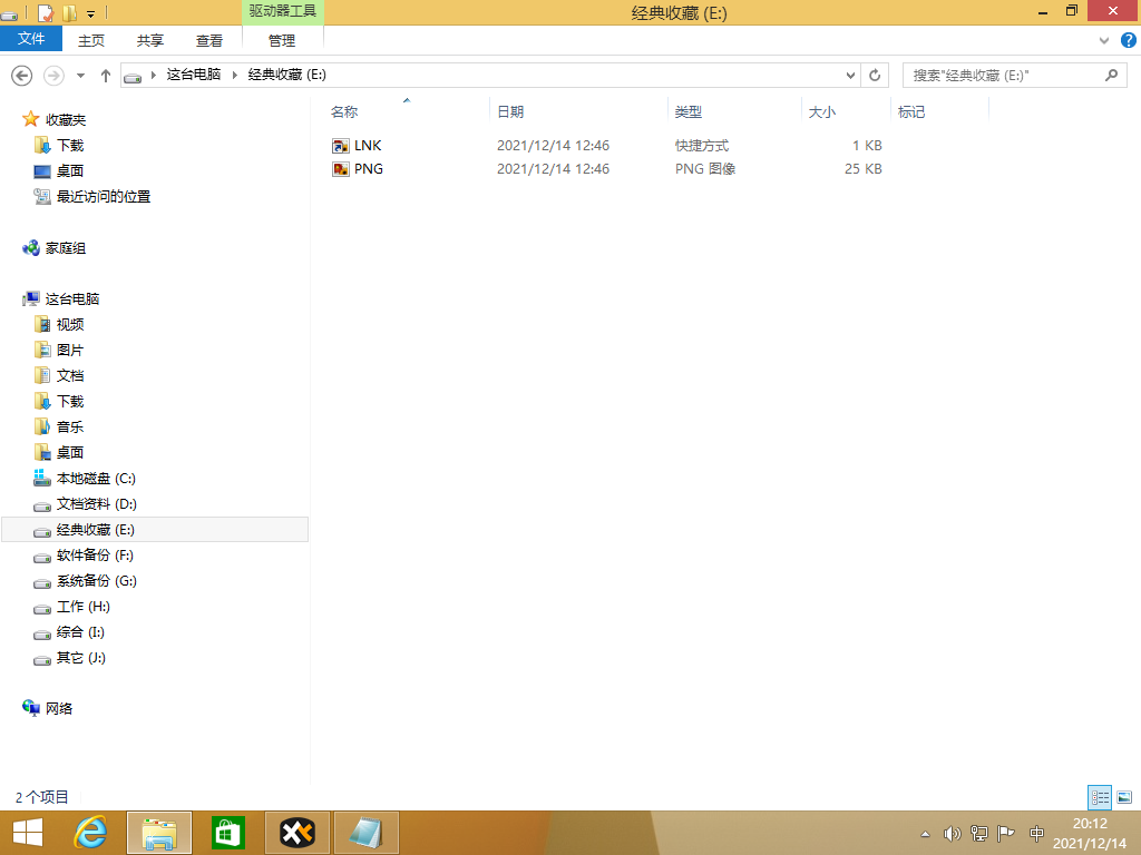

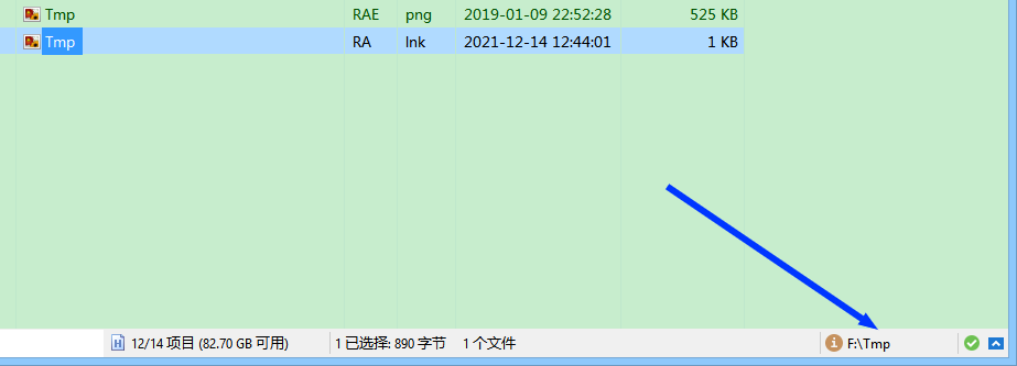

Question 1. For an image shortcut, I hope to get the size of the image and the target pointed by the shortcut.
I hope it to look like this: 200 x 900 F:\Tmp.png
Question 2. I selected a shortcut, and the status bar does not display the file suffix.
I selected a shortcut, and the status bar does not display the file suffix..png
I selected a shortcut, and the status bar does not display the file suffix..png (24.16 KiB) Viewed 1957 times

1) Some of your properties are of the LNK file, some are of the target of the LNK file. The app cannot know which is meant, so I will add a way for you to make it clear to the app:
    + Variable <prop ...>: Now there is an alternative <propt ...> which will
      retrieve the properties from the link target if there is any. For example,
      if "rocky-3.jpg.lnk" is selected:
        echo <prop #image.dimensions>;  //returns nothing (LNK is not an image)
        echo <propt #image.dimensions>;  //returns "770 x 513"
      If "rocky-3.jpg" is selected then both return the same ("770 x 513").
So in the next beta, you definition should look like this:
<propt #image.dimensions> <propt #27> <prop #194> <prop #195>
2) Strange. I cannot reproduce this here.

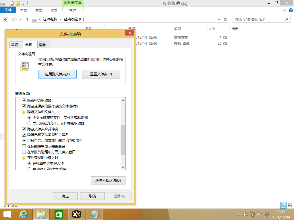

Seems he has suppressed file extensions for list view - could this be the reason?
Posts: 64877
Re: about Custom Status Bar Info
I saw that and tried it, but still could not repro it.

Thinking about it I guess he has suppressed extensions also in Explorer. That could explain it because the link target is returned by a shell function that obeys to these settings.
PS: I will never understand why anybody decides to hide the most important part of a filename.

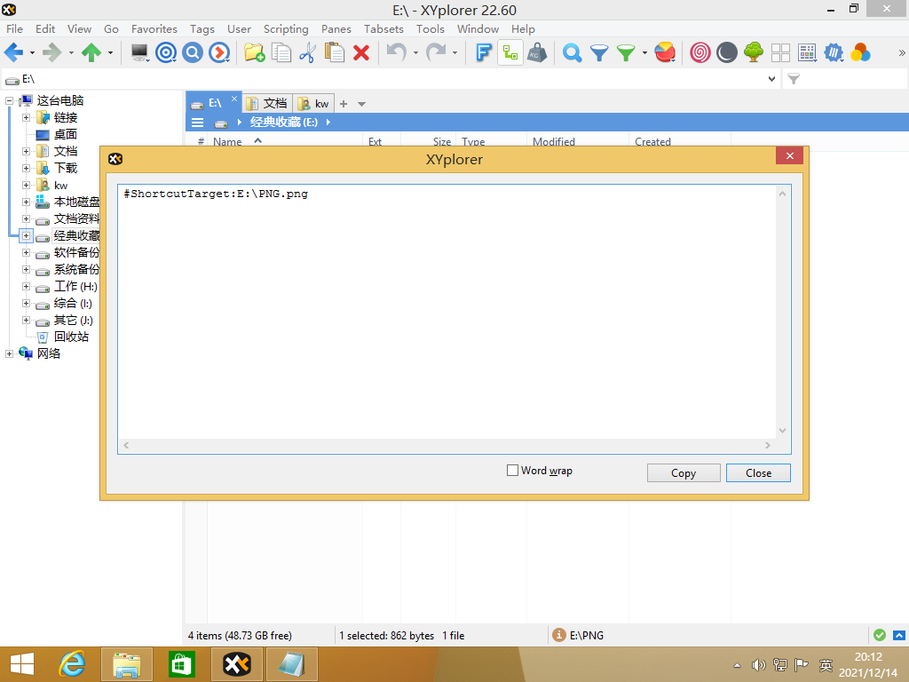

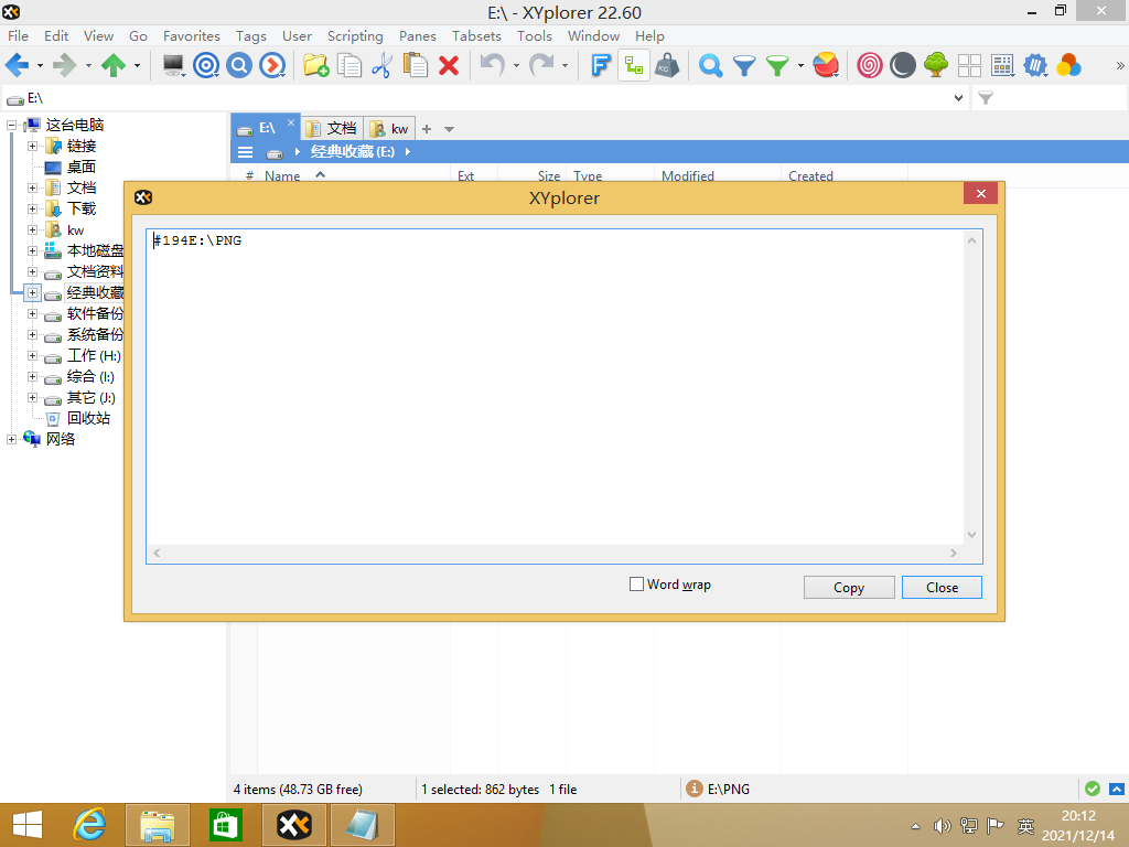

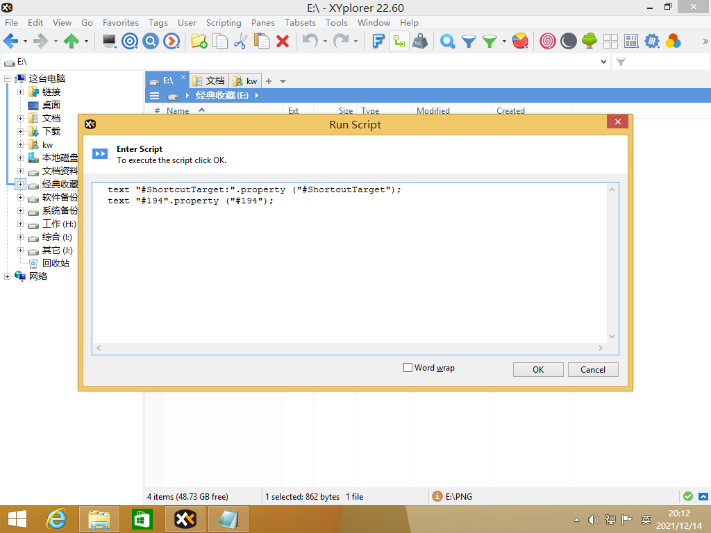

I found the reason. Now I know that the return values of the following two commands are different.
  text property ("#ShortcutTarget");
  text property ("#194");

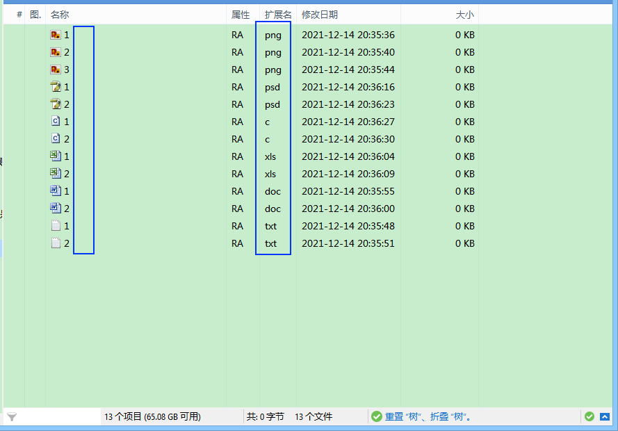

The reason why I hide the suffix is:
1. I know what type of file this is by looking at the icon.
2. Remove the suffix name to make it more concise.
3. My list is sorted by file type, and the files with the same suffix are arranged together. In addition, I have a special column to display the suffix.
Thank you very much.
