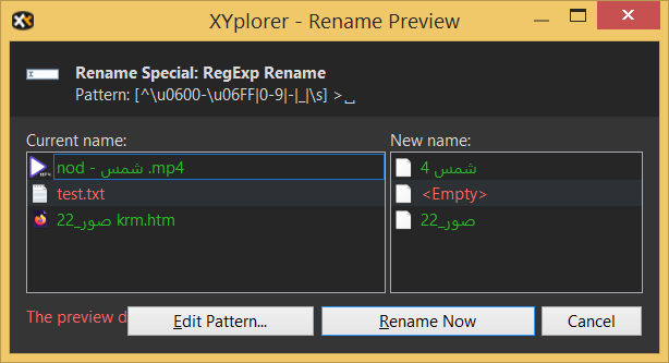

Can regex keep this values in the basename only and also keep the extension?
[^\u0600-\u06FF|0-9|-|_|\s] >
I have another script that seems to work but I'm asking how I can keep the extension while changing what I want in the base name?

my goal is keep [Arabic characters, numbers, space, -_] and remove anything else [\u0600-\u06FF|0-9|-|_|\s]
before:
eng صور_22.txt
جزء اول-1 eng text.pdf
after:
صور_22.txt
جزء اول-1.pdf
Keeping spaces would lead to:
جزء اول-1  .pdf

And your powershell snippet leads to the correct results?
Not here...
eng ور_22.txt
text.txt
.txt
 ور_22.txt
جزء اول1  .pdf
