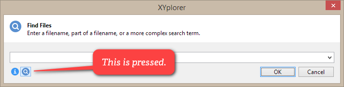

Oh well, you found a bug. If this little button is pressed, the search is channeled through the Find Files tab with all its other filters and conditions...
Going to fix... :evil:

The fix is actually just a change in the caption:
    ! Quick Find Files: When Quick Find Files has been turned on in the Quick
      Search dialog then the search via Cell Context Menu was still called
      "Quick Search" although it was channeled through the Find Files interface.
      Fixed. Now the menu item caption is "Find Files" in that case.
If you decide to use Find Files when doing a Quick Search then you have to live with it. :)

The question is: Why did you press that button in my screenshot?
I didn't knowingly press it!
My interpretation that this was a completely new way of quick searching, not tied to any existing functionality. Seemed nice and clean and simple.
Posts: 67330
Re: More information on new features!
1) In the next beta you will clearly see in the Cell Context Menu that you won't get a Quick Search.
2) If you want a Quick Search unpress the button that says you don't want a Quick Search. :)

(2) - how is the normal user to know that unpressing the button on the F3 dialog should determine the behaviour of the Ctrl-click context menu?
Always the developer's decision, I do understand. I am just a stupid user. I was just trying to give helpful feedback. I won't respond any further as I've said everything I can. I still love XYplorer!

petersboulton wrote: ↑29 Sep 2021 19:35 (2) - how is the normal user to know that unpressing the button on the F3 dialog should determine the behaviour of the Ctrl-click context menu?
Good question. I have to think about that. That setting probably should be in another, more central place...
Posts: 67330
I think I found a better solution now:
    * Quick Find Files: From now on the "Find Files" button in the Quick Search
      dialog *only* affects searches triggered from this dialog. Other Quick
      Searches are not affected and run normally.
Good improvement. Thanks! :tup:
