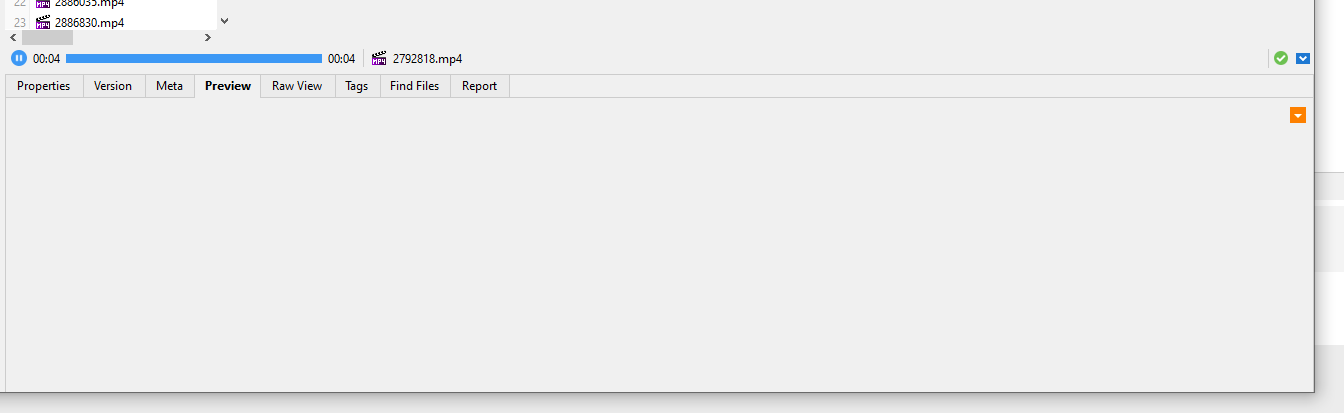

I'm testing the capabilites of XYplorer and I'm having a bit of a headache figuring out why preview not working as intended for me.
Here a list of what works :
- text , doc, ppt files and others
- image formats including jpg, png, gif
- music files mp3
What doesn't works :
- video files including mp4 and mkv (no sound, no video) tested with multiples files from different sources
You can see in my screenshoots some weird ghosting in the preview tab and a blank preview in the info panel
I can play the video files with multiples player (vlc, mpc-be, mpc-hc and windows media player) without issue.
I installed k-lite decoder but that did not help.
I already reinstalled XYplorer twice.
Any help would be greatly appreciated.

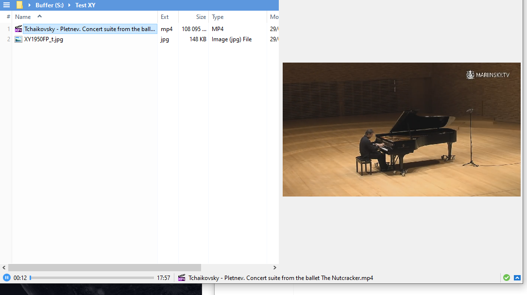

Well,
It's working in the fresh window (fresh; in the adress bar), see the screenshot
So I factory reset my XY by deleting the application data folder and quit without saving (as mentionned in another post)
But after I restart XY the situation loop back to blank/glitchy preview panel.
Weird
Weird

I can't explain why a fresh config works but a factory reset doesn't. If you want to be absolutely sure the reset takes: uninstall XYplorer and then use Windows Explorer to remove the application folder (if still around) and application data folder.StarPotato wrote: ↑29 Apr 2021 21:19 Well,
Weird![]()
FWIW, I've got it working in a VM with the K-Lite Codec Pack installed, both for .mp4 as well as .mkv. Without K-Lite, Windows 10 20H2 doesn't offer video preview in XYplorer.

No luck so far but after a lots of tweaks here and there, I noticed a strange behavior
If I start 2 instances of XY, same folder, on the 1st I preview a video (not working), on the 2nd I preview a video (working)
And vice versa
A picture is worth a thousand words, so here it is https://imgur.com/a/85l752e
And vice versa

In your screenshot the status bar shows the progress of the Quick Audio Preview. It should not be there on a MP4 video preview. Untick this: Configuration | Preview | Mouse Down Blow Up | Mouse Down on Thumbnails and Icons | Audio preview. Maybe it makes a difference.

That particular setting was not checked.
In my first post I said that audio was not working, that is not true; audio plays. Just the video that is not rendering.
Or maybe it's rendering, just not proprely (ghosting effect suggest some rendering is happening).
Hope that help figuring out the root of the issue.
