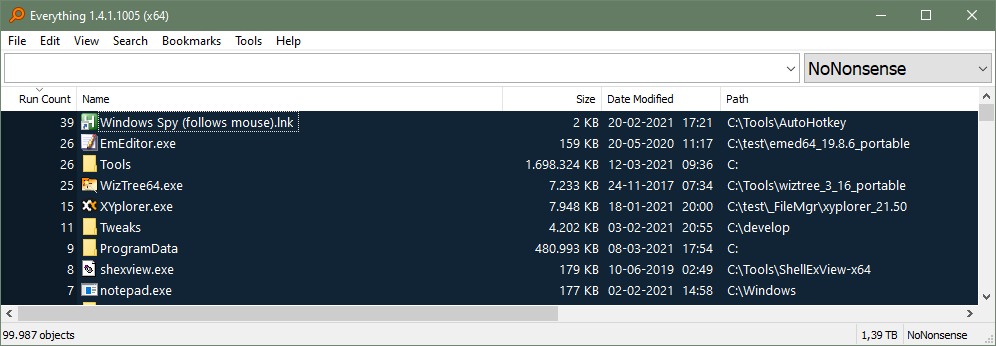

@sweet40:
What you describe is in large parts possible in Everything (voidtools).
For inspiration, when writing your own version, here some details.
Whenever you Enter or double-click a file or folder, it's 'Run Count' is incremented.
When sorted by runcount, the ones with the most 'likes' are on top.
You can configure "Keep History for X days", meaning that after X days not not opening a certain file or foilder, it will be 'forgotten'. At least in the GUI; it is still stored in a file, "Run History.csv". that will looks similar to:
Filename,Run Count,Last Run Date
"C:\Tools\AutoHotkey\Windows Spy (follows mouse).lnk",39,132600367950183749
"C:\2install\Everything\UpdateEverything.cmd",38,132563108848235889
"C:\test\emed64_19.8.6_portable\EmEditor.exe",26,132591636353385438
"C:\Tools",26,132584863376758390
"C:\Tools\wiztree_3_16_portable\WizTree64.exe",25,132569121263390417
"C:\test\_FileMgr\xyplorer_21.50\XYplorer.exe",15,132600359843021042
"C:\develop\Tweaks",11,132349732235184619
"C:\ProgramData",9,132584863862454980
"C:\Tools\ShellExView-x64\shexview.exe",8,132545993656263770
"C:\Windows\notepad.exe",7,132591636444081485
This will not take care of starting files with different programs. For that you will have to associate that filetype with a broker that:
- increments the runcount
- presents a menu with different programs to select from
- start the file with the chosen program.
Should be rather straightforward to script, but I don't know XYPlorer well enough for that (yet!), neither do I have the time at the moment.
FWIW: Such a broker could also be build in Everything itself ( I did write that once). If you need more information about the Everything part, you can ask me ... Everything :D
As a Quick-Fix -instead of writing your own broker - you could associate, let's say .jpg, with OPENWITH.EXE. This is part of Windows (10) and will show a list of programs you previously used to open a .jpg file. Just add the progrmas you want by rightclicking a file > Open With > your program ...
(the list in maintained in the registry : HKCU\software\microsoft\windows\currentversion\explorer\fileext\.jpg\openwith/openwithProgID if you ever need to remove entries)
Hope this gives you some inspiration...

Although this was meant to give more details for implementing this in XYPlorer, I don't mind explaing how this can be done in Everything. Hope it is not too much off-topic...
Installation
  • Download Portable Zip 64-bit version of Everthing (current version: Everything-1.4.1.1005.x64.zip)
  • Extract to an empty folder
  • Start with command everything.exe -instance "Run Count"
    (replace "Run Count" with any text you like, but remember it, as it will be needed later on)
  • Choose Install the "Everything" service
  • Let Everything index your local NTFS volumes (takes a couple of seconds)
Configuration
  • Go to Menu:Tools > Options > General
  • Make sure Store settings and data in %APPDATA%\Everything is unchecked (to keep things portable).
  • Go to Menu:Tools > Options > Indexes > Folders
  • Add your network share(s) here, for example X:\movies or \\server\share\test\ (the last one you need to type in the Folder: box after you pressed the Add button).
  • Go to Menu:Tools > Options > General > Context Menu
  • In the Context menu items: box, click Open (Files)
  • Command = $exec(openwith.exe "%1")
  • In the Context menu items: box, click Open (Folders)
  • Command = $exec("C:\path to\XYplorer.exe" "%1")
    This will open the folder in XYPlorer.
    Note: I could not find a command-line switch to open a folder in a new tab. If there is, use that.
  • Go to Menu:Tools > Options > History
  • Configure Run History to your liking
    That will require some experimenting to find out what works best for you.
  • Click the OK Button to save all changes.
  • Create a shortcut (on your desktop?) to start this "Run Count" instance
    "c:\path to\everything.exe" -instance "Run Count"
Optional
  • Create a Filter to limit the files/folders that are shown in the result list:
    • In the search bar, type (this is an example to show you the Everything Search Syntax)
      X:\movies|"c:\test folder"    !"x:\movies\already done"   !\ignore\   <ext:mpg;mkv   !ext:txt;doc> | folder:   dm:last20days
      (extra spaces added for clarity; they are not needed)
      That will limit the results to files and folders that:
      - are below X:\movies or "c:\test folder", minus the ones that are below "x:\movies\already done" or in a folder called ignore
      - Have extension mpg or mkv and dont have extension txt or doc OR are a folder
      - are modified (dm=date modified) in the last 20 days
    • Go to Menu:Search > Organize Filters
    • Click the New button.
    • Change the Name to something meaningful and click OK
  • Make that filter the default:
    Menu:Tools > Options > Home: Filter = "Something meaningful"
  • Make sure results are sorted by Run Count:
    Menu:Tools > Options > Home: Sort = Run Count (Descending)
Usage
Start Everything with the shortcut you created earlier
Type a few characters from the filename you are looking for
Enter or Double-click to open the file with openwith.exe. Select or add your program to the list
The run count of that file will be incremented. It will now be moved to the top.
That's it.
Note:
You can also change the run count of files manually:
Select one or more files in the resultlist, Menu:File > Set Run Count (also available in context menu)
Extra
Start Everything on system startup
Open path with double click in path column (Results)
Folders schedule
Global hotkey to start Everything
Instead of using Openwith.exe, you can also consider to open the file using XYPlorer, as it has a Portable Openwith Menu
Uninstall
"C:\path to\Everything.exe -instance "Run Count" -uninstall
You can delete the remaining files in that folder manually. There are no related files outside thsi folder.
I hope I didn't skip too many steps ...
