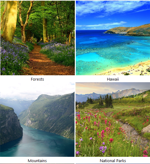

- My G:\Wallpaper\1920x1080 folder has a FVS with a view thumbnail #3 which for me is set at 240x240. I use zoom-to-fill pictures (a folder.jpg in each subfolder) to achieve the view shown below in the first capture.
- All my subfolders under G:\Wallpaper\1920x1080 (e.g., G:\Wallpaper\1920x1080\Mountains) have a FVS with thumbnail #2 set at 240x135 (16x9 like my monitor ratio).

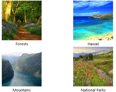

tab("relocate", $home, $i); in a script where $home is the tab's home and $i the tab index and the last "path" used on that tab was a subfolder like "G:\Wallpaper\1920x1080\Mountains", it's relocated to "G:\Wallpaper\1920x1080" correctly, but unfortunately it's in the thumbnail #2 view instead of the saved FVS of thumbnail #3 as you can see by the captures below. If the current folder happens to be in that tab which has the different FVSs, of course it's fine because it's the foreground tab.To see the attached files, you need to log into the forum.
- Posts: 67270
Re: Problem with FVS
Well, you could have mentioned that you are talking about scripting...
Fixed in next version.
