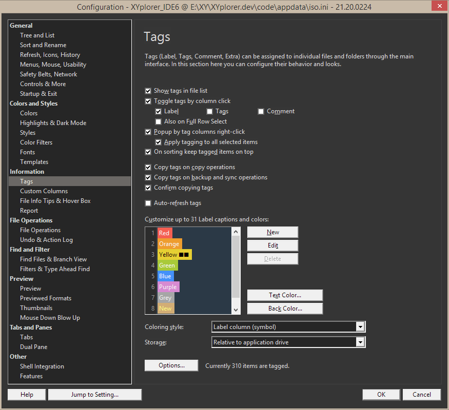

- Posts: 15016
Re: Sometimes, copying files causes XY to exit after it's done
What's the file size of you tag.dat file in MB?
Are these ticked or not?
Configuration | Information | Tags | Copy tags on copy operations
Configuration | Information | Tags | Copy tags on backup and sync operations
Configuration | General | Startup & Exit | Save Settings | Save changes to disk immediately
Configuration | General | Startup & Exit | Save Settings | Apply to... -> Tags (after hitting the button)

Can you post a screenshot of your tags settings? This:

All of those options are ticked. I've played with the first two, unticking them does not fix the issue.I'll play with the last 2. In the screenshot below, one of them is unticked, but that used to be ticked.. makes no difference.
