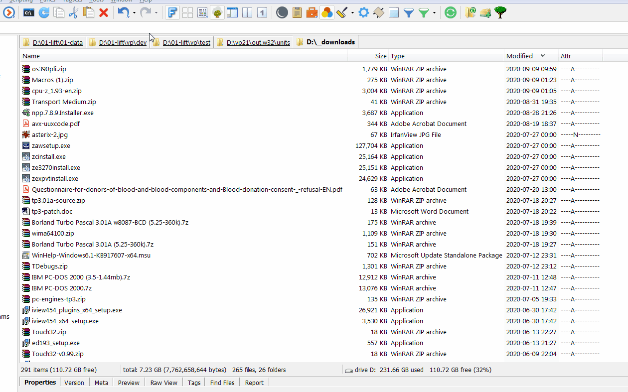

See the attached.
Saved FV does not save column width
