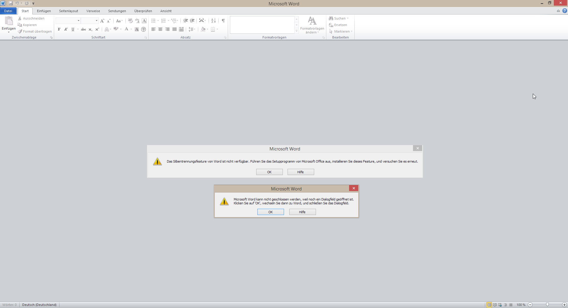

When I want to *preview* this particular DOCX file the following happens:
Yes, Word *opens* (takes a while!) and blocks all interaction with XYplorer. Oh, did I already tell you that Office sucks. :evil:
