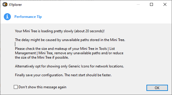

Hi team,
Occasionally I get this error when starting XYplorer and have to clear out the history. Then it comes back up once it's full and slowing down the application again.
I don't use mini tree and don't need history enabled. Is there some way to turn off this feature and get the productivity boost?
Apologies if it's a fairly straight forward solution, but I looked on the documentation for mini tree and there was no mention. Google was not particularly helpful either.

I, too, would like an option to disable the Tree (and mini tree) entirely. For a long while I've been living with very slow startup times for XYplorer (on the order of dozens of seconds). I've also been getting freezes during simple file operations, that bizarrely affect my audio playback with stutters and static.
I just discovered how to switch to the mini tree and that has solved my problem, but it would be nice for those of use who never use the tree to be able to switch it off completely.

Posts: 14742
Re: Disable mini tree history
Workaround:
01. Switch to mini tree
02. Lock the tree
03. Hide the tree
04. Configuration | General | Startup & Exit | [x] No network browsing on startup
05. Save settings and exit
06. Open the XYplorer.ini file (while XYplorer is still closed) and delete the content for
MiniTreePaths=
MaxiTreePaths=
07. Save the .ini
08. Start XY again

That does more or less exactly what I wanted, thank you very much @highend.

Getting back to the topic at hand, the Mini Tree cannot be disabled by default without a workaround like @highend's. As someone that doesn't use the Mini Tree, it seems silly that it would be recording all of these directory changes in the background and then slow down the load times of the program. There should be a way to disable saving browsing history through an option in the program's preferences.

With highend's steps above (including the locking of the tree) there should be no more log of location changes in the Mini Tree section of the ini, thus problem solved.
