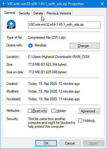

Posts: 14720
Re: How to make it to stop showing the Security Dialog each time I need to copy from a Zip file?
E.g.
For future files:
Run gpedit.msc
User Configuration -> Administrative Templates -> Windows Components -> Attachment Manager
Do not preserve zone information in file attachments -> Enabled
For existing files, unblock them
