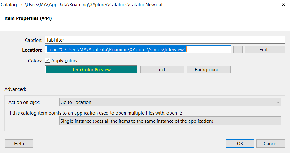

What am I doing wrong?

Re: Save Filters As Collection
Show a picture of the properties of that entry

Here is the catalog property which attempts to call your script. I should note that I added a name to the script. Was that necessary? Did I do it properly?
Using my script requires one click less than #354;
If this doesn't matter you can also use #354; instead.
My script doesn't require a name it works as it is.
I don't know what happens when you execute the catalog entry. Does it present an error message?
You don't need the full path to a script as long as it is in <xyscripts> folder (which seems to be the case).
So you've created a file named
and copied the script I've posted 1:1 into it?
If you're not sure if the script is executed at all, remove the name at the top of it (that you've added)
C:\Users\MA\AppData\Roaming\XYplorer\Scripts\filterview.xys?and copied the script I've posted 1:1 into it?
and use e.g. a
text "hi"; instead...One of my scripts helped you out? Please donate via Paypal

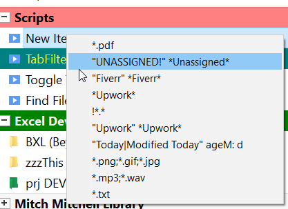

It worked! I started from the beginning. I see how your script saves a step. That is very cool.
Thanks for your help!

- tabfilter-in-catalog-working.png (371.14 KiB) Viewed 3222 times
