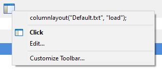

Good evening all,
I have a CTB where I assigned left-click and right-click to different scripts. Hovering over the button displays the name, which is correct; however, when I right-click on the button I see this :
Clicking the 'column...' label runs the script correctly. Is there any way to change that text, for example, Default ?
I have been reading through the manual and haven't found anything for that line.

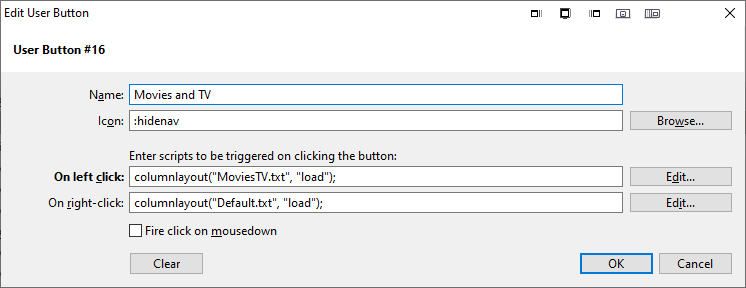

Here is the button code. Did I goober something up in it ?

Afaik no but why aren't you executing the right click script not directly instead of letting XY show it?
CTBNoRClickDefaultCommands=1...

Thanks for the help. Nice tweak ! I applied that my INI and it works directly with left clicks and right clicks ! Now I can quickly switch between certain columns on/off when viewing my movie/tv folders.
Did I just miss that setting in Tools/Configuration ? or is it a manual tweak only ?
Posts: 14720
Re: Label on CTB Right-Click ?
It's only for right clicks and it's a manual tweak

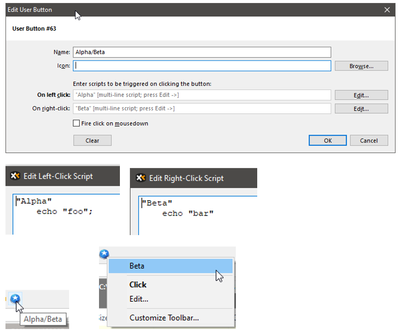

You could try something like this:
