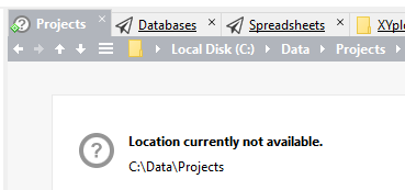

Good afternoon all,
I have experienced the "Location Currently Not Available" for some time but haven't taken the time to really figure out why and what steps need to be taken to recreate. Also, a quick restart of XY always fixed my issue.
Lately I have been working on some BitLocker PS1 scripts. These scripts mount, detach, attach, etc. my VHDXs and do some file maintenance on them. As part of script testing, I am constantly attaching and detaching the files.
In this setup, I can recreate this message each time.
1. XY is opened when the VHDX is not attached/mounted as a drive letter.
2. I browse to the VHDX location, right-click it and choose Mount. The drive is mounted and drive letter assigned correctly.

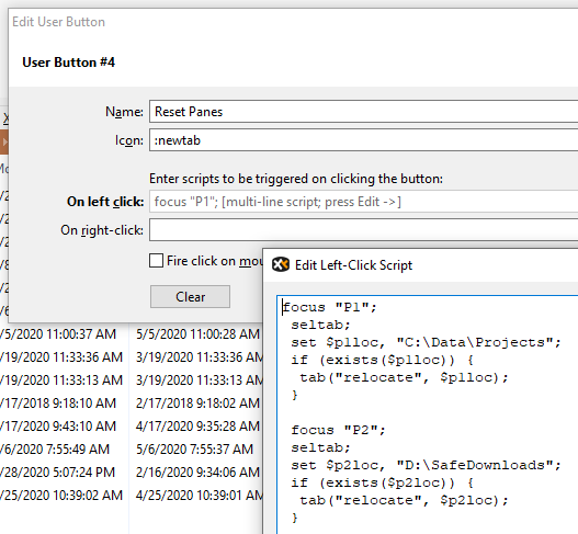

3. I have a CTB that runs a script to reset my panes to specific locations. These locations are always present and are on the HDDs, not on the VHDX. When I click my CTB, it resets the panes and displays the "Location Currently Not Available" message.
NOTE : The tab that displays the message is a pinned, default tab; however, I seem to have this message displayed in every single pinned tab.
4. Restart XY and everything is fine.
