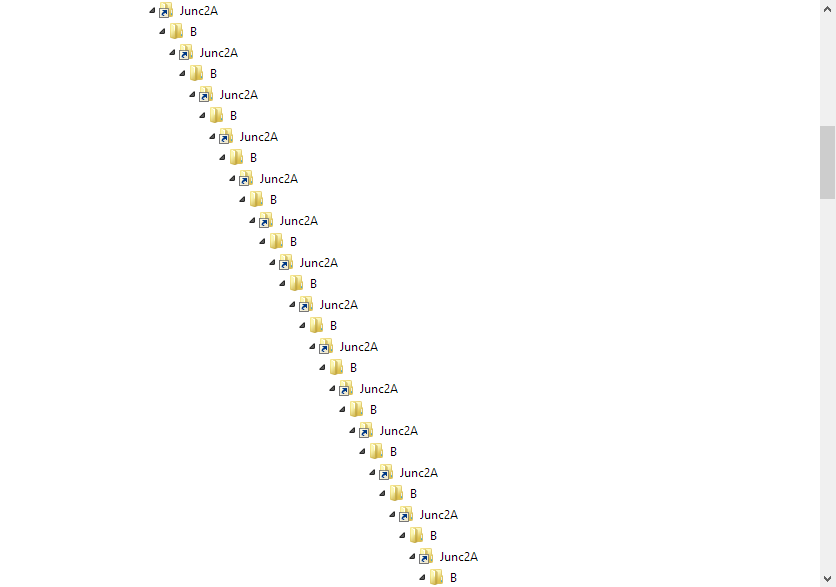

Yes, that's it. I'll fix it. :)
BTW, File Explorer has the issue. It lists 22 elements where XYplorer lists 32, when really there is only one in an endless circular reference.
Posts: 65338
Re: Searching ends up in loop
Note that the File Explorer tree has no checks at all:
XYplorer currently has neither, but it will later...
