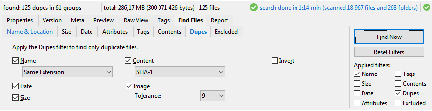

that's what i can show as feedback. ~79Gb scanned, quite fast, especially as it's done on rather old laptop.
default SHA-1, 9 tolerance just for test SHA-256, 9 tolerance. kinda surprised it found 2 extras.
- Posts: 67323
Re: PIH
Thanks! And did the results look good? Not too many false positives are false negatives?
Now the interesting part: You cannot set the hash method here, this dropdown belongs to the "Content" dupe search above. So you have run the same search two times and got different results! Hmm, there is no learning built in...
But I once saw the same here during my tests. I'll watch it...
PS: Your second search was much slower??? That cannot be. Or was it actually the first search? (There is heavy caching here, any non-first search will be MUCH faster).

visual presentation is good, groups are easily determined, text info is well informative. didn't check all dupes, don't really want to sort them right now, but checked about 10-15 groups = no false at all.Thanks! And did the results look good? Not too many false positives are false negatives?
though you say that makes no difference, still probably speed really depends on CPU business, 'cause here i made 9 searches with so to say "different methods" and there are differences in time. though i must mention that 1-4 was while doing some other stuff, and 5-9 was while doing nothing waiting for results. plus can't say that "next runs" were actually "much faster", though again maybe it's due to old laptop.You cannot set the hash method here, this dropdown belongs to the "Content" dupe search above. So you have run the same search two times and got different results!
